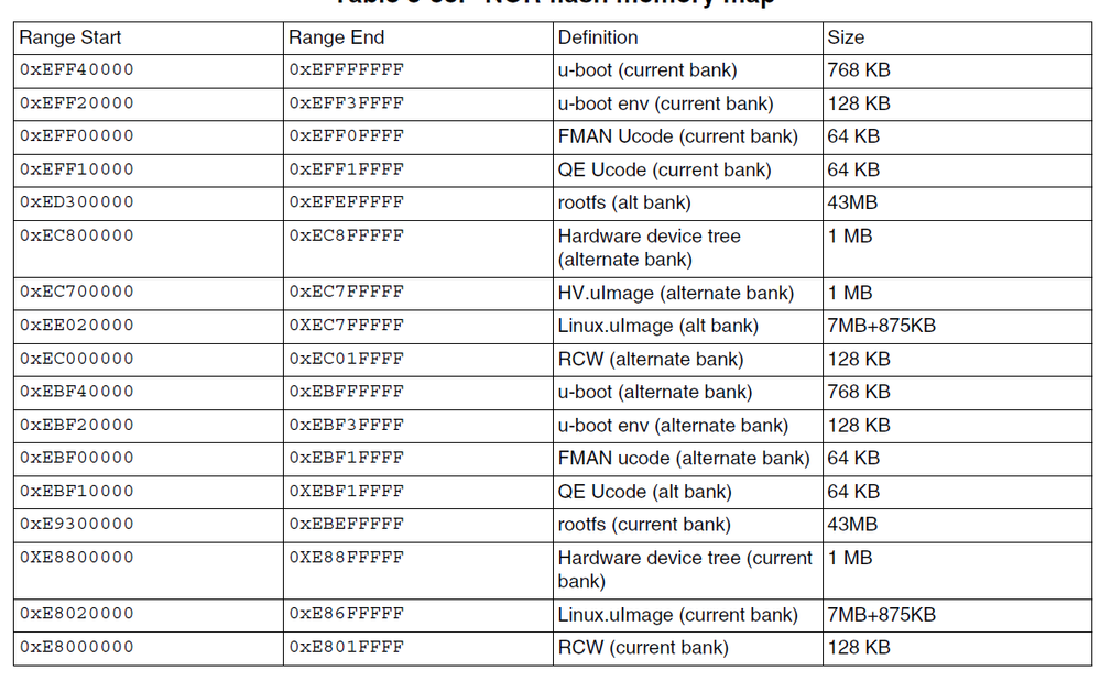

I checked P1040RDB NOR flash memory map, it seems that u-boot(alternate bank) is from 0xEBF40000 to 0xEBFFFFFF.
The entire NOR flash image including all the images in the memory map and reflect the whole 128M flash, if you wan to to you it, you could flash it at the beginning address of NOR FLASH.
I past the NOR flash memory map for you.
Yiping Wang

sareenakp
Hi Yiping,
Sorry! , I mentioned the wrong address  in the above reply for u-boot in the alternate bank
=>erase edf80000 edffffff
=>cp.b 1000000 edf80000 80000
I have been copying u-boot in the range 0xEBF40000 to 0xEBFFFFFF.
And still the issue occurs.
Any reasons/points on what is different in  my setup and yours?

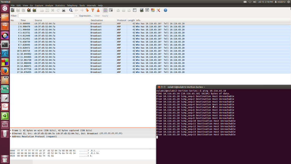

Hello Yiping,
We connected a Linux host system back-to-back with the T1040 board and after configuration of the IP addresses on both sides, we were not able to ping continously. We ran wireshark on the host system to check and have enclosed the two captured screenshots - ping from host to board and vice-versa.

yipingwang
Hello Sareena,
e1000 is PCIe Ethernet interface, and it seems that there is no the E1000 PCI ethernet card on your target.
Please don't ping the target board from the PC, because u-boot cannot detect and reply ARP packet.
Would you please send your u-boot environment (with pri command) to me?
Yiping

yipingwang
Hello Sareena,
According to the above two screenshots, it seems that the PC is sending ARP broadcasting packets continuously, please check whether it would be better if stop sending broadcasting packets from PC side.
Yiping
5,060件の閲覧回数
sareenakp
Hello Yiping,
We have raised a service request of the same . (SR#1-2039245311).
They say , it is a mistake in the board.
Sareena.
