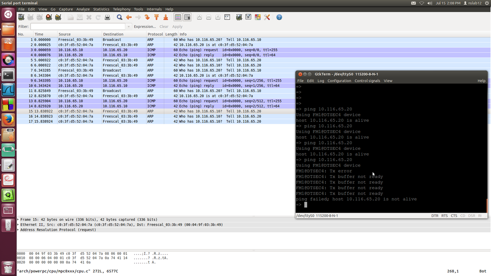

I am working on the freescale T1040RDB box. In the uboot, I have configured the u-boot variables ipaddr, ethaddr, netmask, gatewayip, ethact.
Ping works and indicates that the 'host is alive' message.However after repeated pings, the ping responds with the error 'Tx error'. Thiis error then exists until a restart.
=> ping 10.116.65.1
Using FM1@DTSEC4 device
host 10.116.65.1 is alive
=> ping 10.116.65.1
=> ping 10.116.65.1
=> ping 10.116.65.1
FM1@DTSEC4: Tx error
FM1@DTSEC4: Tx buffer not ready
ping failed; host 10.116.65.1 is not alive
What could be  the reason for this? I have connected to eth0 port on the box (fm1-gb3 port in Linux and FM1@DTSEC4 port in uboot)
In Linux, this works fine and no issue is seen in the repeated ping,.

2,946 Views
yipingwang
I have verified SDK 1.6 u-boot image, and didn't find this problem. I suggest you update your image to SDK 1.6 which also supports T1040RDB and can be downloaded from SDKLINUX: Linux® SDK for QorIQ Processors.
Yiping Wang
2,946 Views
sareenakp
Thanks for the reply.
Even we are using the SDK V1.6
This is the ISO downloaded and used-   QorIQ-SDK-V1.6-SOURCE-20140619-yocto.iso.
Is there any specific configuration/specific that we have missed or may be missing?
Sareena.

sareenakp
Hi Yiping,
Thank you.
I downloaded the image.iso . And I updated the FMAN ucode as well as the uboot.bin in the alternate bank, using the below steps.
But the issue is still seen.
=>tftp 1000000 u-boot.bin
=>erase edf80000 edffffff
=>cp.b 1000000 edf80000 80000
=>tftp 1000000 <ucode_file_name>.bin
=>erase ebf00000 ebf1ffff
=>cp.b 1000000 ebf00000 $filesize
Should I be downloading the entire NOR flash now? If so how?
Thanks and Regards,
Sareena.

sareenakp
Hi Yiping,
Sorry! , I mentioned the wrong address  in the above reply for u-boot in the alternate bank
I have been copying u-boot in the range 0xEBF40000 to 0xEBFFFFFF.
And still the issue occurs.
Any reasons/points on what is different in  my setup and yours?

sareenakp
The flash image QorIQ_SDK_T2080V1.1_T1040V0.3_T1040RDB_20140422_NOR_Flash.bin is 134.2 MB, as compared to the 128 MB flash.
Also this will overwrite both the banks. Is it possible to update both the banks at the same time?

sareenakp
Hello Yiping,
We connected a Linux host system back-to-back with the T1040 board and after configuration of the IP addresses on both sides, we were not able to ping continously. We ran wireshark on the host system to check and have enclosed the two captured screenshots - ping from host to board and vice-versa.

yipingwang
Hello Sareena,
e1000 is PCIe Ethernet interface, and it seems that there is no the E1000 PCI ethernet card on your target.
Please don't ping the target board from the PC, because u-boot cannot detect and reply ARP packet.
Would you please send your u-boot environment (with pri command) to me?
Yiping

yipingwang
Hello Sareena,
According to the above two screenshots, it seems that the PC is sending ARP broadcasting packets continuously, please check whether it would be better if stop sending broadcasting packets from PC side.
Yiping
