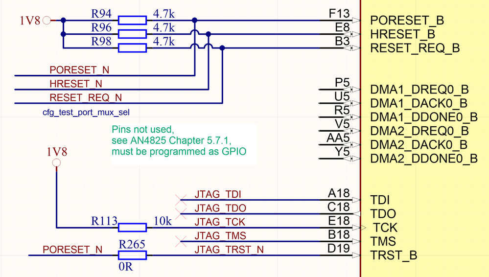

lukaszprzeniosl
Thanks for the document John. Indeed there is some "magic" switch... In our design, the TRST_B is directly tied with PORESET_B:
I wonder a bit either this can really mean anything- that they are not disconnected at any point. I think in the end they are both pulled to VDD anyways.

lukaszprzeniosl
John,
Do you mind refering the datasheet by a number or link it? In the RM I cannot find this figure. Also, In our design the TRST_B line is tied to PORESET_B by an 0R resistor, so it would seem its the way it should be after reading your explanation.

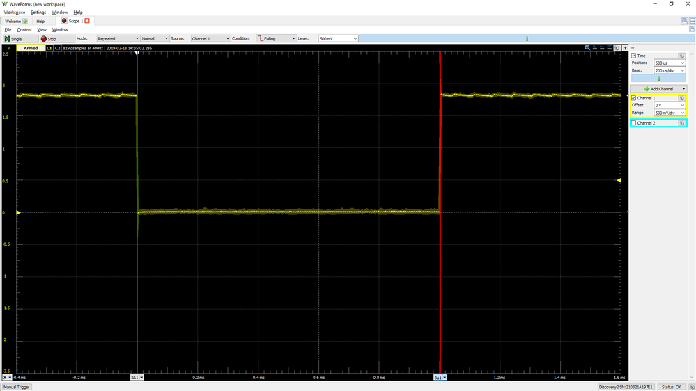

lukaszprzeniosl

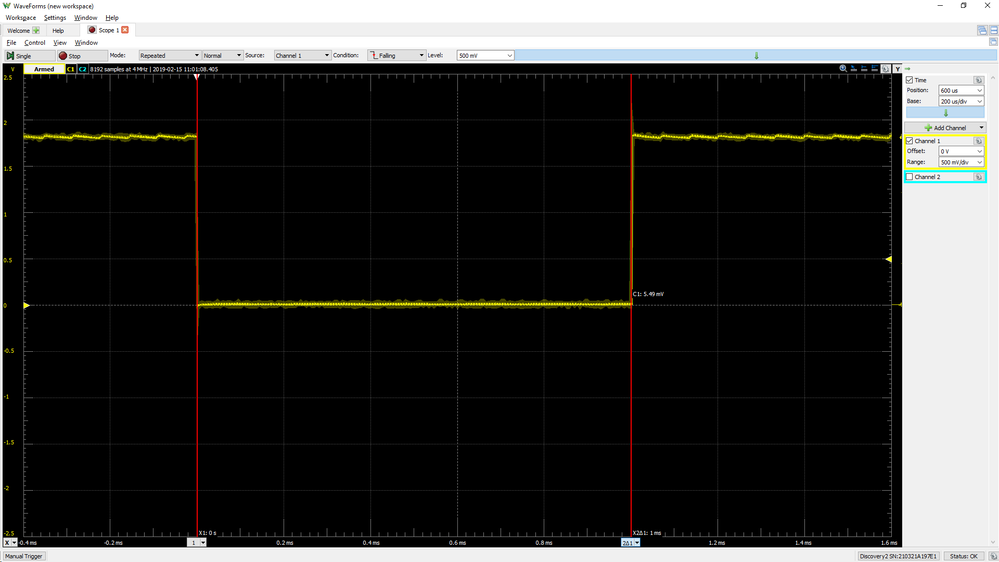

Hello Ufedor, thank you for answer. I have implemented the 1 ms reset routine, here is the scope view of the PORESET_B line:
The device (T1040) behaves the same way. I am able to reset it while its in the bootloader, but not after the main operating system has started to booting. Do you have any other ideas?

ufedor
Please check that the PORESET_B assertion is the same after the main operating system has started to booting.

lukaszprzeniosl
Hello Ufedor,
During or after boot, the PORESET_B behavior is the same:

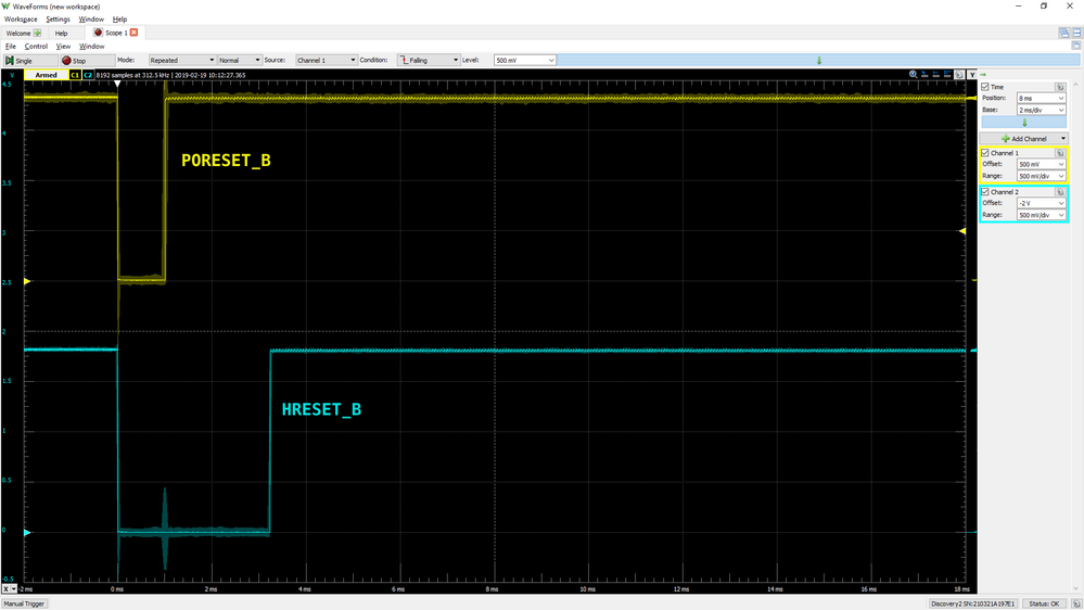

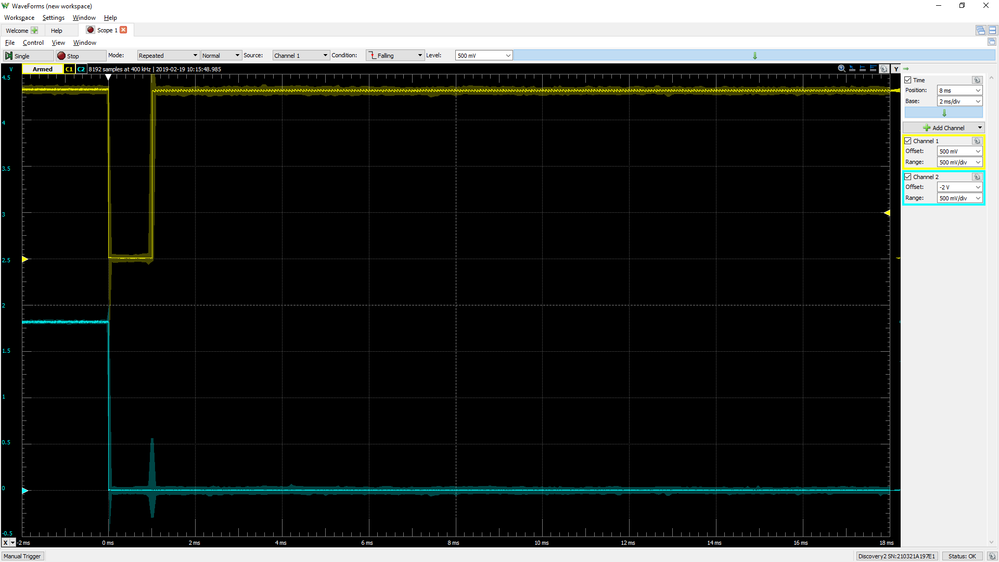

lukaszprzeniosl
Ufedor,
So far I have the scope results for PORESET_B and HRESET_B captured in parallel. The reason for the device not being reset seems obvious now, but the source of the problem is still unknown for me, Please take a look at the 1st scope: I reset the device during bootloader phase:
Keep in mind that the HRESET_B signal is pulled up to VCC by a resistor. The FPGA controlling the CPU has the HRESET_B connected pin configured as High Z for all the time. Nothing inteferes the GRESET_B line.
Now this is what happens when I reset after the system has booted:
Further reading of the HRESET_B pin without power recycle will show that it is low all the time...
What do you think?
13,460件の閲覧回数
ufedor
