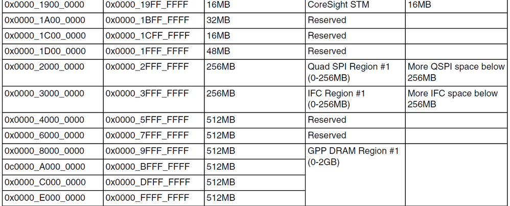

How to load a u-boot.elf or u-boot.bin using lauterbach JTAG in internal memory of LS2084a ?
Is LS2084a has any internal SRAM memory and what is memory location for internal SRAM memory and size of it ?
Currently U-BOOT text location started at 0x30100000. As per "include/configs/ls2080a_common.h", "CONFIG_SYS_TEXT_BASE" set to 0x30100000.

Hello Balaji Mohan,
Please refer to the following memory map for OCRAM(internal memory) from LS1024A Reference Manual, OCRAM is from 0x18000000 to 0x181fffff.
Please refer to the following memory map, the address 0x30100000 is IFC NOR flash.
You could refer to u-boot debugging section in https://community.nxp.com/docs/DOC-331981 .
