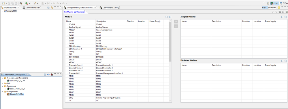

Dear all,
I would like to develop using LS1020, is there a 'Pins onfig tool' like i.Mx?
Previously,  I used the 'Pins Tool for I.Mx processors' when I developed the i.Mx6 Solox.
2,070 Views
addiyi
There is suck a tool for LS1020, named Pin Muxing Configuration tool, part of QCVS and included in CW for ARMv7.
Adrian

2,070 Views
katsuyoshi_oyam
Thank you for teaching me such a useful tool!!
I'm happy to be the best now!!
My development work schedule has shrunk significantly.
2,070 Views
Pavel
There is no pins configuration tool for the LS1020. Use the Chapter 3.4 in the LS1021a Reference Manual for pins configuration:
https://www.nxp.com/webapp/Download?colCode=LS1021ARM
Pavel Chubakov
2,070 Views
katsuyoshi_oyam
Thank you for your answer!!
I will try hard to see the reference.
