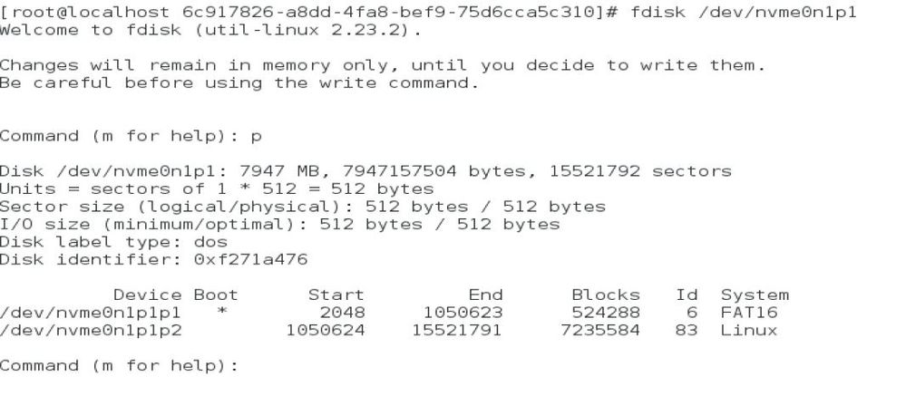

The SDCard was partitioned into two - one bootable partition of 512MB (FAT16) and other partition with remaining space on the card.

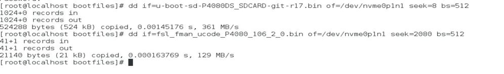

The following two commands were followed to copy u-boot binary image and  FMan microcode (both obtained from SDK ISO file) to the SDcard.
After execution of these commands, no files are visible on the SDcard.

Steps to prepare bootable SD card for the P4080DS:
1) Write U-Boot to SD card (CHECK that  "sdb" corresponds to the SD card in your case):
dd if=u-boot-sdcard-2016.01+fslgit-r0.bin of=/dev/sdb bs=512 seek=8
2) Write FMan microcode to SD card:
dd if=fsl_fman_ucode_p4080_r3.0_106_2_18.bin of=/dev/sdb bs=512 seek=1680
3,918 Views

On exceuting the above commands, the following is the log
[root@localhost files]# dd if=u-boot-sdcard-2016.01+fslgit-r0.bin of=/dev/sdb bs=512 seek=8
1632+1 records in
1632+1 records out
835840 bytes (836 kB) copied, 0.0582739 s, 14.3 MB/s
[root@localhost files]# dd if=fsl_fman_ucode_p4080_r3.0_106_2_18.bin of=/dev/sdb bs=512 seek=1680
59+1 records in
59+1 records out
30540 bytes (31 kB) copied, 0.0152906 s, 2.0 MB/s
After mounting the SD Card back, no files are seen on the card.
P4080DS u-boot console also does not show any output.

1. My linux pc detects sd card as a physical device and not as SDHC card. Is that the reason why "dd" command does not show any files copies onto the card? ( i can copy files using "cp" command to the card, which are visible on mounting the device)
2. Is there no need to partition the SDcard?

1) Correct.
2) For U-Boot - no need.

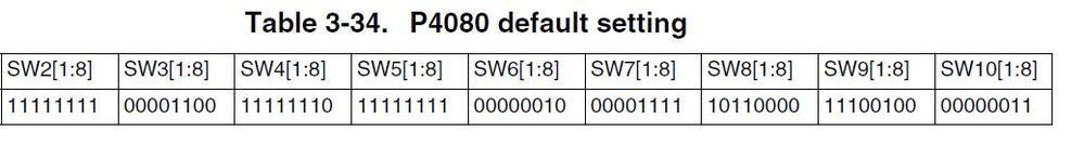

What are P4080DS on-board configuration switches settings?
Use "dd" to "copy" first 2MB of the prepared SD card and attach resulting image for inspection.

On formatting the SD Card and re-running the above two "dd" commands, I could boot from the SDCard with the following switch settings:
SW1: 00110011
All other switches are default settings as given in the SDK manual
