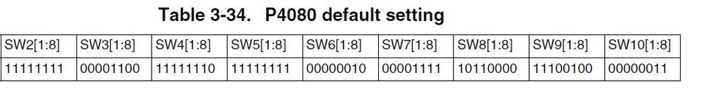

What are P4080DS on-board configuration switches settings?

On formatting the SD Card and re-running the above two "dd" commands, I could boot from the SDCard with the following switch settings:
SW1: 00110011
All other switches are default settings as given in the SDK manual
