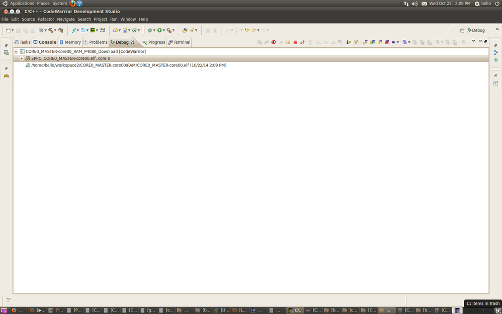

hymalaibello
Hi!
Hello Hymalai,
You could use "Download" when create the bare board project, the debug program will be download at the effective address 0, so downloading program to DDR or SRAM depends on what kind of memory is mapped to effective address 0 in the initialization file.
Yiping
When I try to do that,  the program do not debug. and SRAM is mapped to effective address 0 using law, and DDRs are disabled.
Thanks!
Hymalai Bello
2,162 Views
yipingwang
Hello Hymalai,
In the default RAM lcf file P4080DS_gcc-eabi_core0.lcf, the stack and heap definitions are out of the range of 1M CPC as SRAM, and the TLB miss exception will be encountered. Please use SRAM version LCF file  e500mc_gcc-eabi_SRAM.lcf, which I mentioned in the previous thread.
Yiping
2,162 Views
hymalaibello
Hi!
Can I use the registers for  Partition allocation of CPC (CPC1_CPCPAR1....) when I am using CPC as SRAM?  Is for assign  a private space to each core.
thanks!
Hymalai Bello
