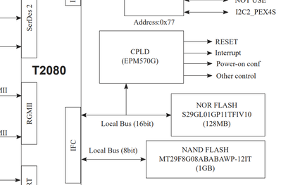

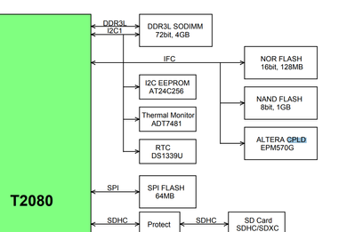

One more query on T2080 Evaluation board:
What is the purpose of connecting T2080's IFC to CPLD?
