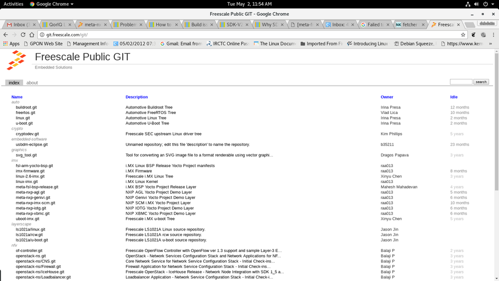

Well , I applied the above patch, but now this step  fails:
bitbake -c patch virtual/kernel
WARNING: Failed to fetch URL git://git.freescale.com/ppc/sdk/linux.git;nobranch=1, attempting MIRRORS if available
ERROR: Fetcher failure: Fetch command failed with exit code 128, output:
fatal: unable to connect to git.freescale.com:
git.freescale.com[0: 192.88.156.202]: errno=Connection refused
ERROR: Function failed: Fetcher failure for URL: 'git://git.freescale.com/ppc/sdk/linux.git;nobranch=1'. Unable to fetch URL from any source.
ERROR: Logfile of failure stored in: /home/debdutta/QorIQ/QorIQ-SDK-V2.0-20160527-yocto/build_t1042d4rdb-64b/tmp/work/t1042d4rdb_64b-fsl-linux/linux-qoriq/4.1-r0/temp/log.do_fetch.21697
ERROR: Task 2 (/home/debdutta/QorIQ/QorIQ-SDK-V2.0-20160527-yocto/sources/meta-freescale/recipes-kernel/linux/linux-qoriq_4.1.bb, do_fetch) failed with exit code '1'
So I cant get the kernel source. Seems there is some problem in fetching it from the above repository. However, I can see the "git.freescale.com" from my internet browser. (attached screenshot)Screenshot from 2017-05-02 11-54-48.png
