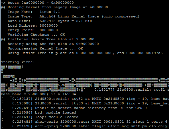

j_wallace
Using the kernel image built with "bitbake fsl-image-minimal" and the corresponding dtb let me have my rootfs on SD card.
1) I did not modify sources/meta-frescale/recipes-fsl/images/fsl-image-kernelitb/kernel.its
2) cleaned previous build
3) built fsl-image-minimal
4) built uImage following the previoulsly mentionned thread
5) put uImage and dtb in my SD card partition root.
6) Modified bootcmd in u-boot to load the kernel and the dtb
7) Then => boot.
I got some dirty prints (picture below) but the kernel completed the boot till the loggin prompt and I confirmed that /dev/mmcblk0p1 is mounted on /. Now I have to investigate this dirty print but everything seems almost fine.
