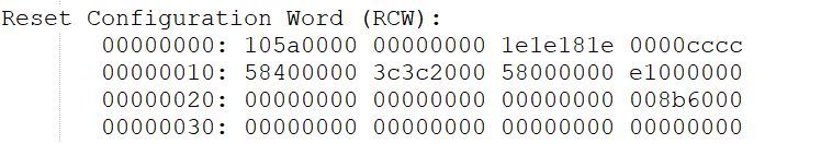

Two questions regarding the above issue
1. Should the board be connected to "linux host pc" alone? ( My pc is a windows pc running linux on VMware . My tftp server is also on the windows machine. The above serverip matches with that of the windows system)
2.  In the section " 9.8.1.7.2 About U-Boot and network interfaces"  of the SDK v2.0 reference manual, an example log shows RCW as shown
but RCW from my boot log is as shown
Is the difference in RCW causing the issue?
Thankyou in advance.
5,280 Views
ufedor
Concerning the host it is of course possible to use Windows and TFTP server running on it.
The FM1@DTSEC2 operation though the EC2 is not affected by the RCW difference.
