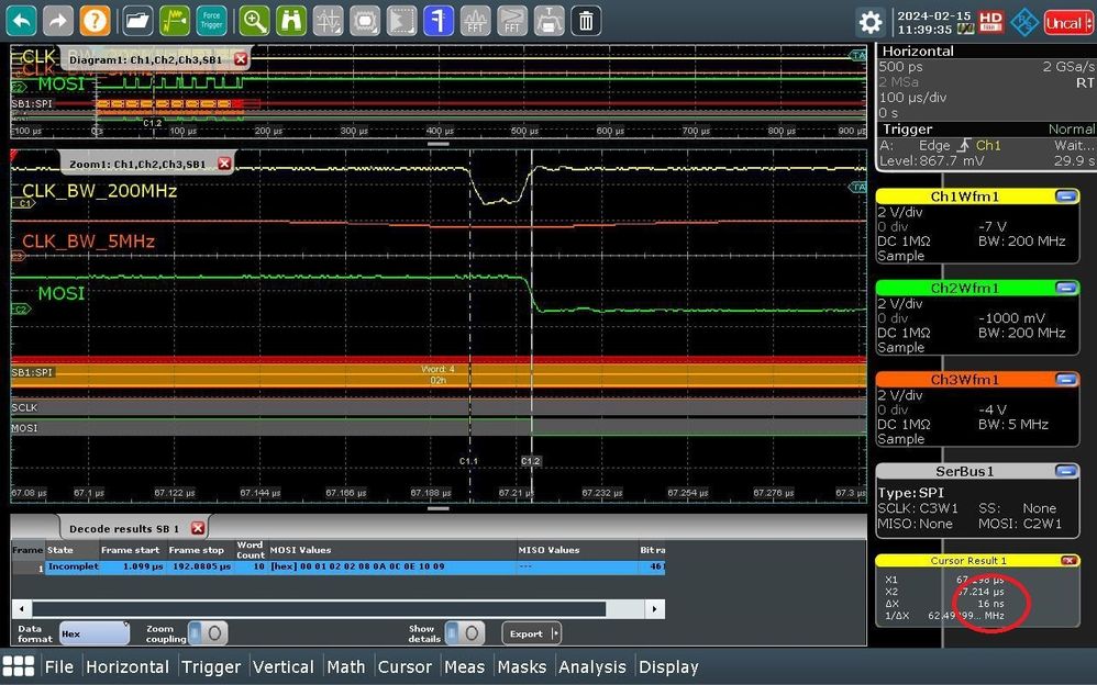

I´m, planning to use the SPI- Controller of the LS1046a. In a first test setup, I made some measurements at the Testpoints TP9 (SPI_CLK) and TP10 (SPI_SOUT) of the Eval Board LS1046ARDB.

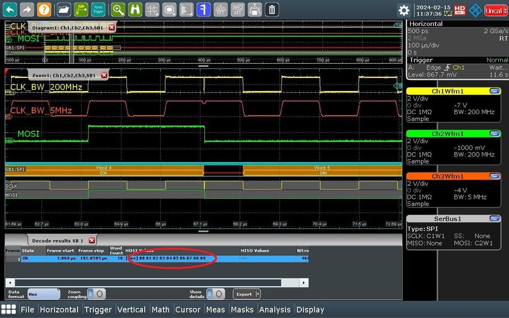

But there is some unexpected behavior on the SPI Bus.
Depending on the size of the Tx data buffer, I observe a much too short negative clock phase (~16ns instead of 1/(2*500MHz) = 1us)).
I used an Oscilloscope to distinguish, if a whole negative clock phase is just to short or if there is only one longer positive clock phase with a unwanted glitch.
But you can already see that MOSI changes from 1 to 0 during these short 16ns Pulse.
I used two probes at the clock. The yellow one with a Bandwidth of 200MHz and the orange one with a Bandwidth of 5MHz only. A third probe was connected to SPI_SOUT (TP9).
If I select the yellow trace (BW: 200MHz) as a Clk source for the SPI- Analyzer, the interpreted data are equal to the transmitted.
So, no surprise: As far as I select the filtered orange trace as a clock, there are missing Bits in the analyzed data:
Do you already know this behavior? Is a workaround available to get a “clean”, uniform clock cycles?

I've encountered with the same problem on LS1046AFRWY board: "merged" pulses on SCLK in every SPI transaction (see the photo below), and the absence of tCSC and tASC delays (not shown). Linux 5.10.52, Yocto Kirkstone release.
SCLK is yellow, MOSI is pink, MISO is green.
In the following photo SCLK is zoomed in.
The problem is gone after applying the patch. 
Yellow is still SCLK, and pink is CS1 now
Thank you so much!

srechermann
Like you can see in the spidev_test output and the screenshots of the oscilloscope in the previous post, the clock speed is set to 500kHz (one clock cycle = 2us) by the spidev_test tool. This works for the most of the time except these sporadically appearing 16ns pulses. Limiting the bandwith of the red channel of the oscilloscope to 5MHz was just to show what could happen when the SPI Slave overlooks this very short 16ns pulse and therefore samples the data incorrectly. So the general problem I wanted to show was the faulty SPI CLK with the much too short 16ns pulse.
