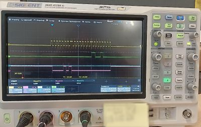

Hello, everyone!
I've encountered with the same problem on LS1046AFRWY board: "merged" pulses on SCLK in every SPI transaction (see the photo below), and the absence of tCSC and tASC delays (not shown). Linux 5.10.52, Yocto Kirkstone release.
SCLK is yellow, MOSI is pink, MISO is green.

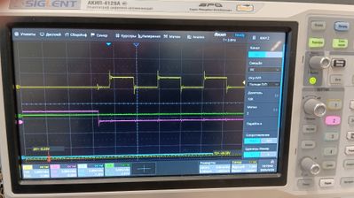

In the following photo SCLK is zoomed in.
The problem is gone after applying the patch. 
Yellow is still SCLK, and pink is CS1 now
Thank you so much!
