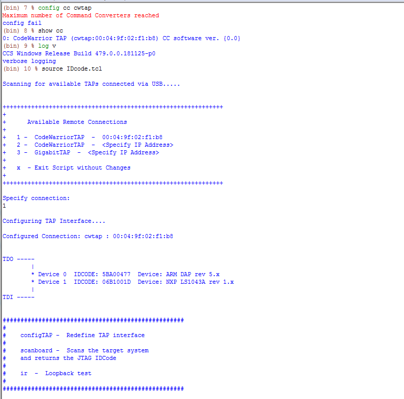

Pavel
Check JTAG connection on your board using the Figure 100 of the LS1043a Datasheet:
https://www.nxp.com/webapp/Download?colCode=LS1043A
Test your connection to your board using the following commands in CCS:
config cc cwtap
show cc
and
log v
source IDcode.tcl
See the following page:
https://community.nxp.com/docs/DOC-94804

lingguan
Thanks for your reply.
I use CCS and test my connection:
I just set SW3[6] = 1 for JTAG configuration. LS1043ARDB, CWTAP and CWH-CTP-CTX10-YE are all new, so the pyhsical connection really have some errors?
Sincerely.
