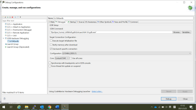

In "Target Connections" panel, please duplicate LS1046A_RDB and configure Target Connection Configuration(CodeWarrior TAP Connection).

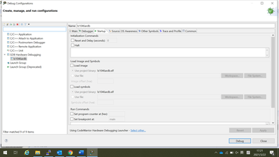

Then click Debug->Debug Configurations->GDB Hardware Debugging-><project name>, please configure "Debugger" panel as the following.
Please configure Startup panel as the following

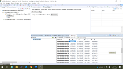

Then click "Debug" to connect to the target board, then click "suspend" in CodeWarrior IDE.
Then click Window->Show view->Memory, click "+“ to read memory 0x82000000, please check whether you could read similar content as the following.

rashmikj
Please find attached captured file .
