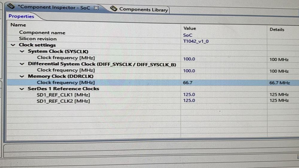

Hi everyone,
We are working on a T1042 based Custom board. We have some differences when compared with RDB. We removed swithes which inditaces boot from where (NOR,NAND,SD).
What procedure should we follow when creating new PBL/RCW to change boot location using latest Code Warrior Flash programmer and QorIQ Suite together ? Is there any guide documentation ?
We are also open for other ideas.
Regards.

It is reasonable to read the "QCVS PBL Tool User Guide" (Freescale\CW_PA_v10.5.1\eclipse\ProcessorExpert\Help\PDF\PBL Tool - User Guide.pdf)
Please provide the processor connection schematics for inspection.
Which boot source is planned to be used - refer to the QorIQ T1040 Reference Manual, 4.6.4.1 Reset configuration word (RCW) source.
This should be what I'm looking for. I'll only do 16 bit NOR flash booting. Does Code Warrior QCVS - RCW project have config variables to change these variables to generate new PBL ?
Sorry, which "these variables"?

I mean, If it's posssible with Code Warrior, which configuration property should I change in a QCVS - RCW project ?
