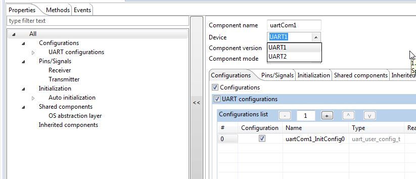

Is there a reason that uart0 does not showing up as available for the kl25z using processor expert, fsl_uart component in KDS?
Using PE, SDK 1.2, KDS 3

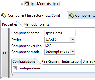

Hello M J:
UART0 instance is different so it has a separate driver in KSDK. Please try with the fsl_lpsci component:
Regards!
