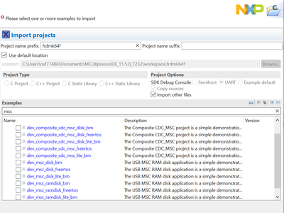

nxf77486
Hello @AsafTv
Can you please help me with the name of the example of the SDK you are currently using (see image attached for reference).
Also if you have a program for USB descriptor it will be helpful to understand better the situation. I usually use the USB Device Tree Viewer.
