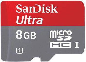

6. K64 is full speed controller, the best theory value is 1.25MB(12Mb/8), considering the protocol overhead, the value should be lower. I have tested sdcard performance on k65 KHCI (full speed controller), the sdcard is a sandisk ultra 1, and  the write buffer size is 64*512,  use the release version example and plug out the jlink after download the example, the performance is ~1MB.
The following is the sdcard I use, you could use a better sdcard with higher performance. Then the performance will be higher.
