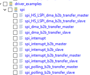

I recommend use an example of the SDK from the MCU [spi_interrupt_b2b_transfer_master] then in the library fsl_spi.h you can find some functions to write and read. If you are searching for a command to read and write the part of ADXL it will show it in the datasheet of this part.
In the SDK you will found some examples.
Pavel

Pavel_Hernandez
Pavel
7,101 Views
SadaK
Thanks, this helps..!
