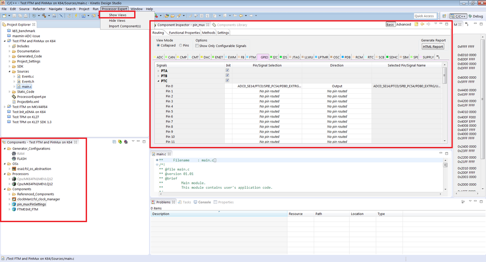

I think that it is important to understand how the Processor Expert project is structured.
The configuration of all components is located in the ProcessorExpert.pe file. The content of this file is visible in the Components window and the Component Inspector window, see below:
If you do not see these windows, please select the command in the main menu Processor Expert - Show views.
This command display all default Processor Expert windows.

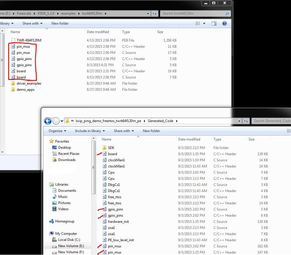

Maybe I will add more explanation to what I mean.. I have the LwIP + Freertos ping demo source code. In that folder if we see the board configuration files its board.c/.h, pinmux.c/h and gpio_pins.c/.h
These files must be created by the process expert / or through PE from Design studio. When I load the same PE files and generate the code. I am getting a many other source files which is not there in the demo source code and also board.h is not getting created, so is it that the design studio does not generate the board source file and also with the KDS new components would generate the other component files? The PEB which I am using is essentially the same file which I received with the demo source code.

I am sorry I know that there is an issue in the Kinetis SDK. The Processor Expert .peb file has been used for generating these files (board.c/.h, pinmux.c/h and gpio_pins.c/.h) but these source code file have been also modified manually (because Processor Expert does not allow generate conflicts in pin routing functions) for many target boards. These board support configuration files (board.c/.h, pinmux.c/h and gpio_pins.c/.h) are used for all demo application and therefore the manual modification was necessary for many target boards.
In addition, you cannot generate code directly from the .peb file (e.g. TWR-K64F120M.peb). You must create a project for the same target device and use the .peb file for importing of the Processor Expert embedded components into the project. Therefore the project generate more files that are used in the KSDK board support demo examples (they just copied these file from an existing project and modified the content of these files for the KSDK demo examples purpose).
