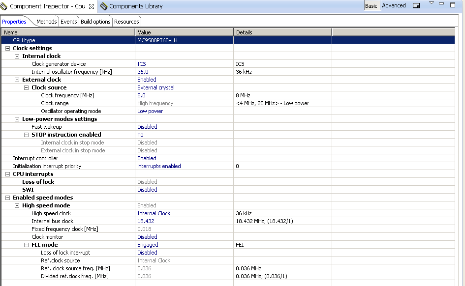

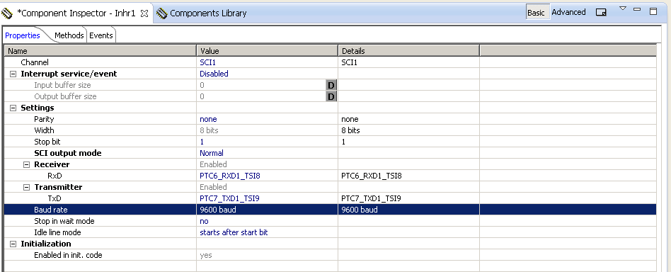

First, the baudrate is off by roughly 10%
When I set it to 9600 baud, the length of one bit sent from the mcu is 115us instead of 104us
Here are a couple of screenshots on how I've set the timing:
(I changed the internal oscillator to 36kHz to allow for a wide variety of baud rates)
I can trick it into communicating in the correct baud rate if I set the baud rate to 10500 though...

The baud rate  issue is solved.
The component inspector for the cpu had the wrong addresses for the trim register (under advanced settings)
As default they were set to 0xFF6F and 0xFF6E, but should be 0x303A  and 0x303B.

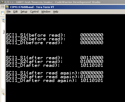

I've written a program that writes the contents of the UART-registers to a terminal window,
before and after I receive a character, and then it reads it one more time after that.
The code is something like this:
send_registers_before_read();
Term1_ReadChar(&ch); //Reads one character from PC
Term1_SendChar(ch); //returns the received character to the PC
send_registers_after_read();
send_registers_after_read_again();
And this is the result:
The problem seems to be that the RDRF and IDLE-bit (SCI1_S1 bit 5 and 4)doesn't get reset until it's been read a second time.
So they indicate that the receiver data buffer is still full...
The function "Term1_ReadChar(&ch)" reads both SCI1_S1 and SCI1_D and that should be enough to reset the RDRF and IDLE bits
The fact that the data still in the buffer(SCI1_D) is shifted one bit, I no longer think is a problem in itself.
That's probably just residual data, that shouldn't be read anyway...

cristianzamfire
  Hello Fredrik,
  The "Trim value address" property is not the address of the trim register, it is a location in flash memory from where the generated initialization code reads the value that will be used to initialize the trim register. You can see this assignment in generated code (file cpu.c, function _EntryPoint). The trim value is written in that flash location by the debugger when the code is downloaded.
  If you need to change the internal oscillator frequency it is not enough to change it in PEx, you must also inform the debugger. You can do that in Run -> Debug configurations, Main tab, Target settings group, press Edit button, then Advanced Programming Options, and write the desired frequency in the box on the bottom of the window. This will cause the debugger to compute the trim value properly.
  I could  not reproduce the second issue, my echo example worked perfectly and all registers values were correct. Perhaps it is related to the first problem, can you please check if the problem persists after fixing the internal oscillator frequency?
