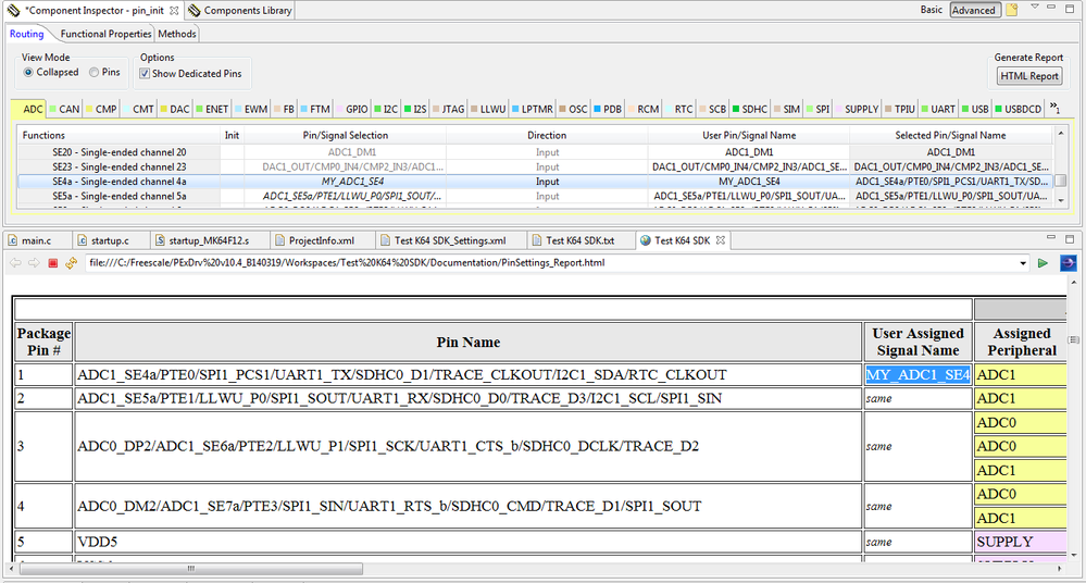

I've successfully muxed out all of the pins using Processor Expert.  Now I want to make a schematic symbol and lay out a PCB using the resulting pin assignments.  Solution Advisor outputs a CSV file with the pin numbers and assigned signals.  This file is exactly the format I am looking for.  How do I get this sort of file from Processor Expert?  Solution Advisor is not a solution, since I needed Processor Expert to squeeze everything in and choose the exact pins for each function.

Hello Greg,
Processor Expert tool provides HTML reports of PinSettings components. Open the Component Inspector of the PinSettings components, select the Routing tab and click on the "HTML Report" button. The generated HTML report contains all information about pins - Pin assignment on package, Pin Allocation Report, Routed Pins and Routable Pins tables, see the example below. You can select table you need and convert it to CSV format (for example by MS Excel - copy the table and past it in a new sheet in MS Excel, click on the Save As and select the CSV (MS-DOS) format, click on Save).
Marek Neuzil

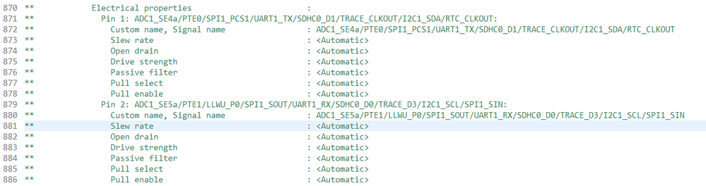

I'm trying to export the Functional Properties to excel.  Is this possible?  When I generate the HTML report the 'Functional Properties' of the pins are not generated.
If they were it would be quite simple, one would just open the xml file with excel.
Also, do you know where, in the Kinetis documentation (K24) I would find a description of the default functional properties of a pin. Cant find it anywhere?

Hello Dave,
The "Functional Properties" report is available in a text format in the generated PinSettings program modules (e.g. Pins1.h). There is Electrical Properties settings report in the header file introductory comment, see for example:
Marek Neuzil
