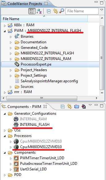

I have imported your project and it seems set to RAM.
Please check if your project looks as on this picture:
Does it match?

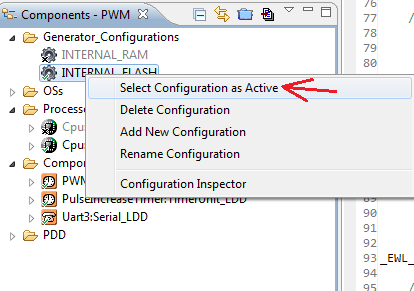

If not, select the Generator configuration using command "Select active configuration":
(This is the normal way how the targets should be switched in PEx as it ensures that it changes CPU settings and also switches CodeWarrior build configuration):
Then try to clean and build the project again.
