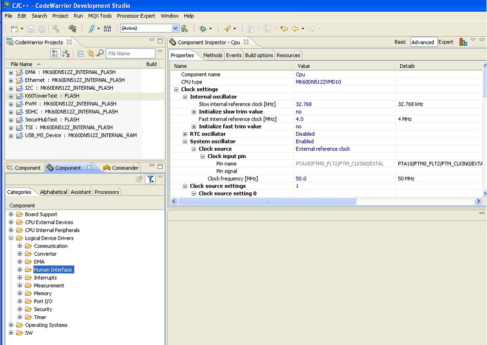

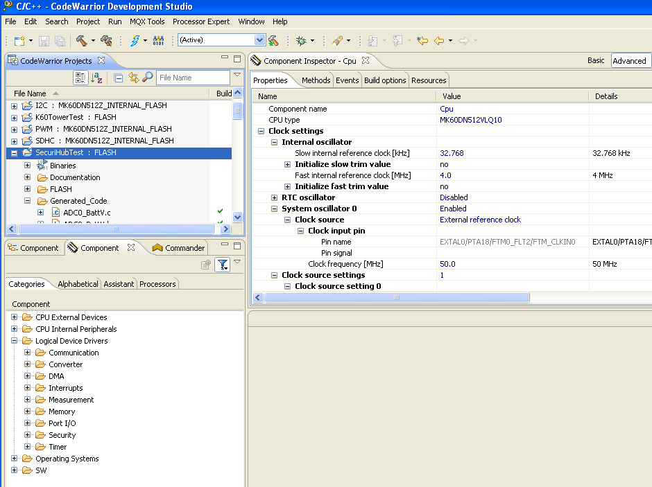

I try to add "Touch Sense Input" for my MK60D512D512VLQ10 (LQFP144pins)  input my project by PE, but I can't find the component from the "component Library" in PE.
When I highlight my project, in the "Logical Device drivers" there is no "Human Interface", my MCU is K60D512D512VLQ10 (LQFP144pins), I'm sure that There are TSI for this MCU,
All the PE examples in "C:\Freescale\CW MCU v10.4\MCU\CodeWarrior_Examples\Processor_Expert\Kinetis\TWR-K60N512\" have the "Human Interface" in the "component Library", the MCU is MK60D512D512ZVMD10 (BGA144pins).
How can I add the TSI into my project?

WithOut_HumanInterface.bmpWith_HumanInterface.bmpCW10.2 and CW10.4 get installed in my PC.
I check with my CW10.2 project, there is "Human Interface" in the "component Library", the MCU is MK60DX256ZVLL10 (LQFP100).
In the CW10.2 PE example project PWM, there is "Human Interface" in the "component Library", the MCU is MK60DX256ZVMD10 (BGA144).
I my CW10.4, I create two project:
K60TowerTest,  with "Human Interface", the MCU is MK60D512D512ZVMD10.
SecuriHubTest, without "Human Interface", the MCU is K60D512D512VLQ10.
Maybe something wrong with PE for K60D512D512VLQ10???

rabbit
Is the TSS_Library as I attached? It seems working.
But why no "Human Interface" in the "Logical Device Drivers" folder if I choose MK60DN512VLQ10?

santiago_gonzal
Hello Rabbit,
The reason is probably that you are comparing two MCUs with different silicon version. Have a look at the lack of "Z" in the MK60DN512VLQ10 partnumber.
This means that the TSI module is slightly different, and maybe the Rev 2.x of silicon is still not supported by the "Human interface" component
Anyway, if you want to use the Human interface component, you can generate the code, and then adapt it using the AN 4445, which specifies the differences between the TSI peripherals of both silicon revisions.
http://www.freescale.com/files/32bit/doc/app_note/AN4445.pdf
