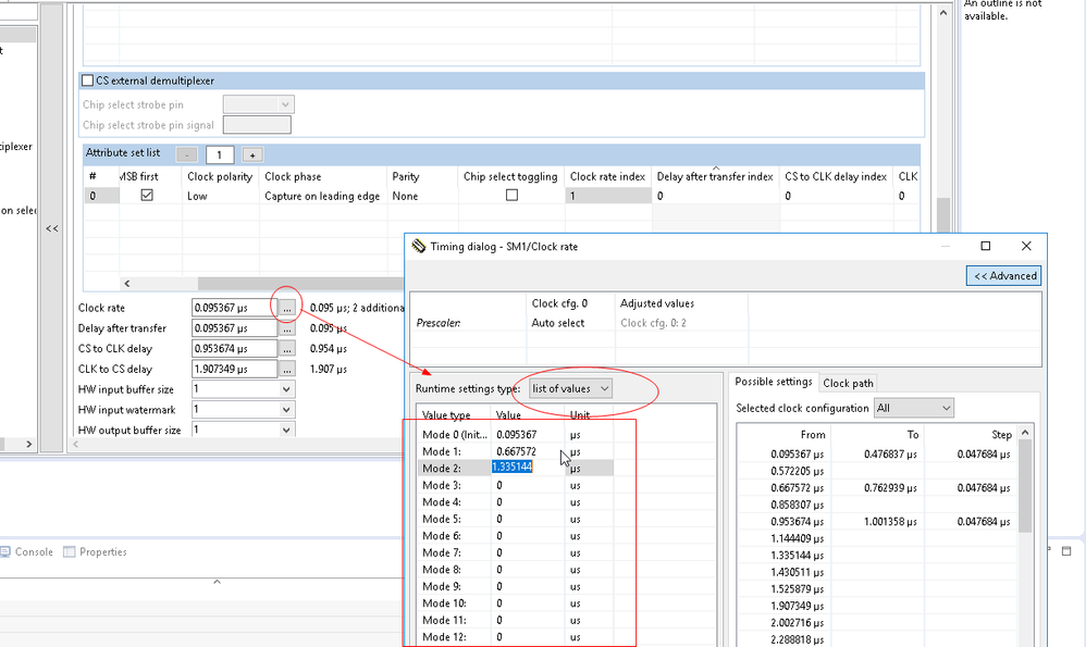

Hello at everyone :smileyhappy:,
i want to transfer data from the MK10DXVLH7 to the DAC7616 per SPI Module.
Can some tell me, what i have to do to solve my problem?
I can't select any entry in the Processor Expert SPI configuration (attribute set list).
Why I can not type in the times, which are given in the datasheet?
Please look at the picture i added.
Thanks for your help,
Roy

Hello Roy Trapp ,
About your question, I have checked your picture , If you want to choose the data under "Clock rate index"
of Attribute set list, first you need to configure more than one "Clock rate" , in default , there is only one clock
rate setting , so there is no option we can use under it .
Open "Clock rate" configuration view, choose "list of values" in "Runtime settings type", then configre values:
After do this , you can use the "Clock rate index" list .
Hope it helps,
