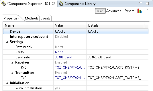

ConsoleIO properties setup
This component redirects printf command output to FRDM USB virtual serial port which is connected to UART0 pins PTA1/UART0_RX and PTA2/UART0_TX.
The serial device, speed and pins are configured in inherited Serial_LDD component.

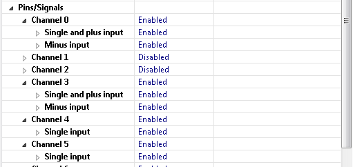

Pins configuration - all pins available on the board are enabled:

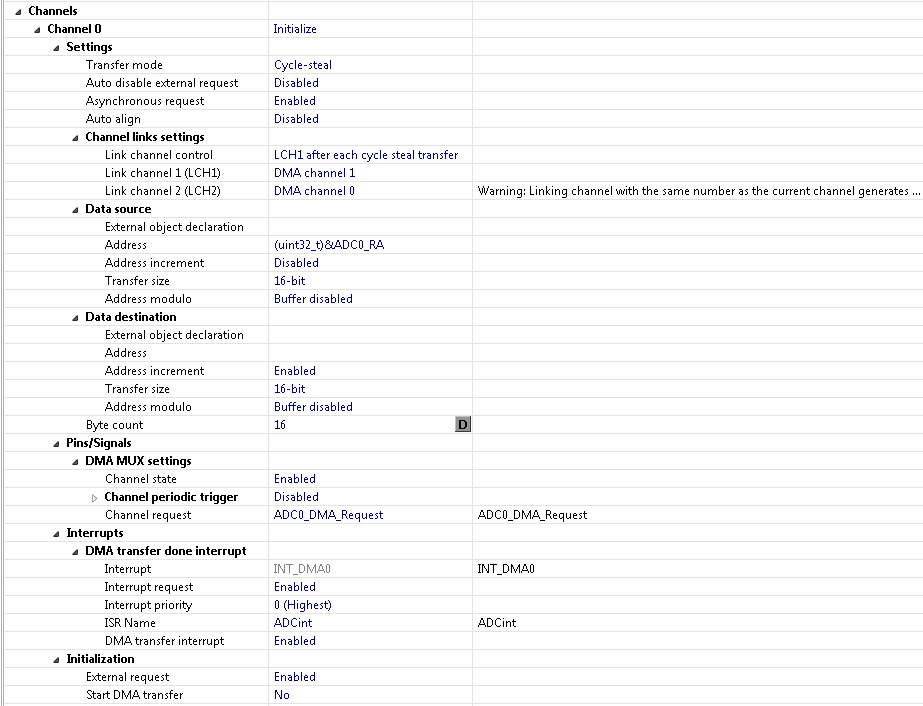

DMA Channel 0
  • 16-bit results are transferred from ADC0_RA register (see proprerty Data source / Address).
  • Transfer mode is Cycle-steal, which means that only one transaction is done per each external request.
  • The destination address initial value is not filled in the inspector because it's filled repeatedly in the application code.
  • Channel linking is set to trigger channel 1 after each transfer
  • DMA mux settings for the Channel 0 are enabled and ADC0_DMA_Request is selected, which is the signal from ADC when the conversion ends.
  • "DMA transfer done" interrupt for this channel is enabled. The ADCint ISR function will be called.
  • External request (request from ADC) is Enabled to start the transfer. Byte count will also be changed before every sequence
Property values:
