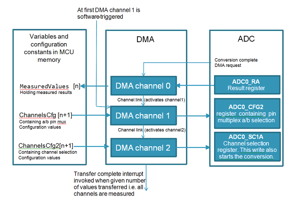

The DMA in this example is used for controlling all the channel switching, pin mux selection and reading the results for series of measurement into a memory buffer.
Results are written to serial console (virtual serial port) provided by the FRDM board.
The Direct Memory Access (DMA) channels are configured for writing and reading ADC registers the following way:
  • DMA channel 0 reads converted results (ADC0_RA register)
  • DMA channel 1 changes the ADC pin group selection multiplexer (ADC0_CFG2 register) using values from memory array ChannelsCfg
  • DMA channel 2 selects the ADC channel and starts conversion (ADC0_SC1A register) using values from memory array ChannelsCfg2
The data for the DMA channel 1 a 2 are prepared in the ChannelsCfg and ChannelsCfg2 arrays prepared in memory and the DMA operates in the following cycle:
In the beginning, the DMA channel 1 transfer is started using software trigger. This selects the pin (a/b).
Then, DMA channel 2 is immediately executed because of enabled DMA channel linking. This configures the channel and starts the conversion.
After the conversion is complete, the result is read by DMA channel 0 and stored to results array. Channel linking executes the Channel 1 transfer and the cycle continues.
After all needed channels are measured (DMA byte counter reaches 0), the DMA Interrupt is invoked so the user code is notified.
See the following figure describing the process:

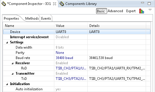

ConsoleIO properties setup
This component redirects printf command output to FRDM USB virtual serial port which is connected to UART0 pins PTA1/UART0_RX and PTA2/UART0_TX.
The serial device, speed and pins are configured in inherited Serial_LDD component.

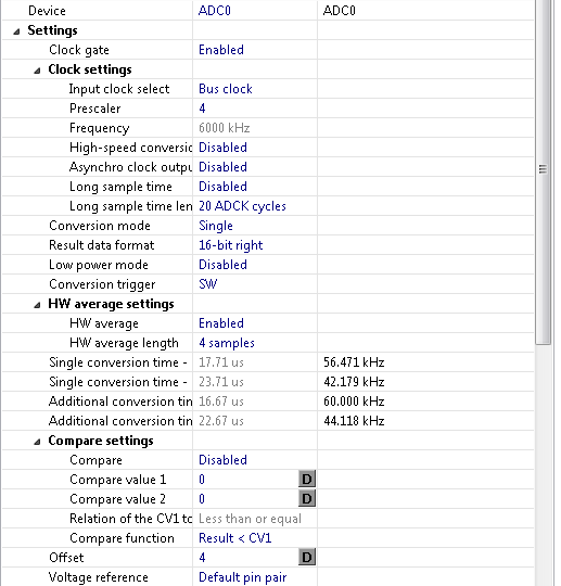

Init_ADC properties setup
The Init_ADC provides ADC initialization code with all channels enabled and set to single-ended.
The clock can be selected according to any valid value, according to the user needs.The same with HW average settings.
Compare functionality will not be used in this demo.

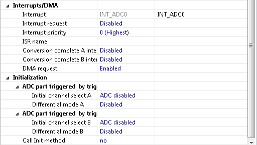

Interrupts,  DMA and Triggering - Interrupts are disabled, DMA request is enabled. Triggering is disabled, as it’s not used in this demo project, However, the application could be extended to use it.

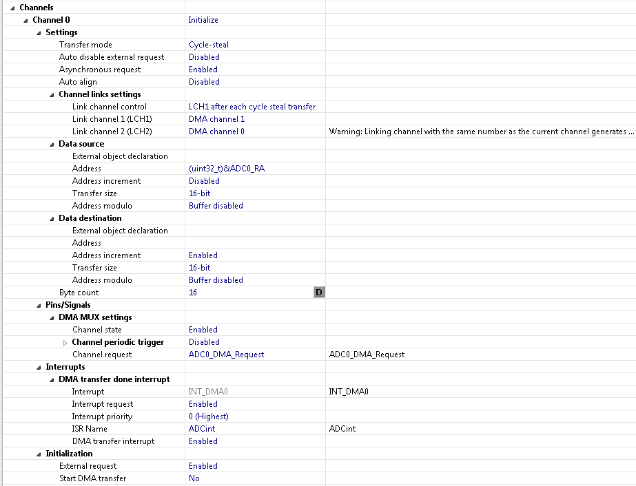

DMA Channel 0
  • 16-bit results are transferred from ADC0_RA register (see proprerty Data source / Address).
  • Transfer mode is Cycle-steal, which means that only one transaction is done per each external request.
  • The destination address initial value is not filled in the inspector because it's filled repeatedly in the application code.
  • Channel linking is set to trigger channel 1 after each transfer
  • DMA mux settings for the Channel 0 are enabled and ADC0_DMA_Request is selected, which is the signal from ADC when the conversion ends.
  • "DMA transfer done" interrupt for this channel is enabled. The ADCint ISR function will be called.
  • External request (request from ADC) is Enabled to start the transfer. Byte count will also be changed before every sequence

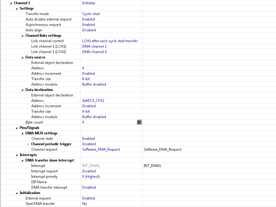

DMA Channel 1
  • DMA channel 1 changes the ADC pin group selection multiplexer (ADC0_CFG2 register) using values from memory array ChannelsCfg.
  • Please note that the source address initial value is not filled, will be set in the application code along with the Byte count value.
  • There is no HW trigger for this channel, it's set to be triggered by SW only (and by linking mechanism, which will be used).
  • The linking from this channel is set to trigger CH2 after the transfer.
  • No interrupt is enabled for this channel

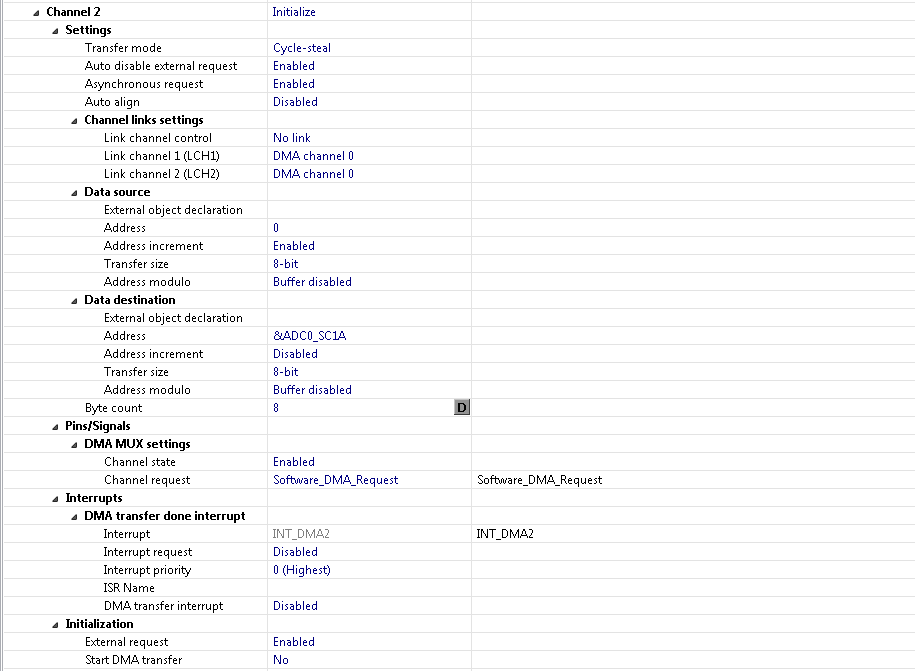

DMA Channel 2
  • DMA channel 2 selects the ADC channel and starts conversion (ADC0_SC1A register) using values from memory array ChannelsCfg2.
  • No channel is linked after the transfer ends - No link.
  • No external channel request is selected, this channel transfer is triggered by linking from CH2.

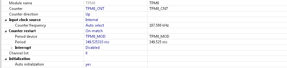

TimerUnit_LDD
  • It's used in the application code to provide delay to slow down console output.
  • The TPM0 counter is used with the period of approx. 350ms.
  • No interurpt is used.
  • Auto initialization is enabled.
