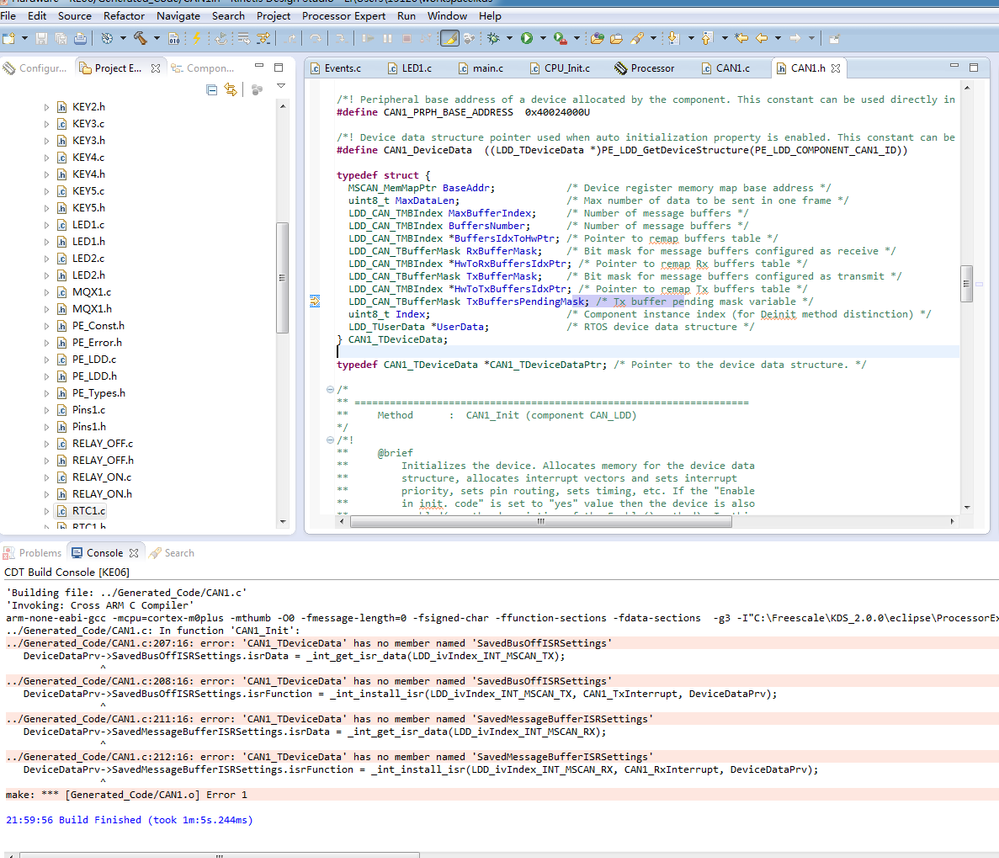

MKE06Z128VLH4 ,use Processor Expert create program CAN1 component ;after compile find error

in the struct  CAN1_TDeviceData ;can't find  "SavedBusOffISRSettings"......
typedef CAN1_TDeviceData *CAN1_TDeviceDataPtr;

This is known issue of CAN_LDD component driver. We have fixed the issue and there is a hot fix for KDS 2.0.0 and CW MCU 10.6.x. See attached hot fix packages.

Hello 王俊峰,
Please have a try to only add the CAN component , check  it whether can work well.
If it can work well , please tell me how to configure the CAC component , then it can show the error, i will test it on my side.

Hello Alice_Yang:
  I have add the CAN_LDD component only,create source and compile ,i work well;
then i add MAXLite component, create source and compile ,same error
