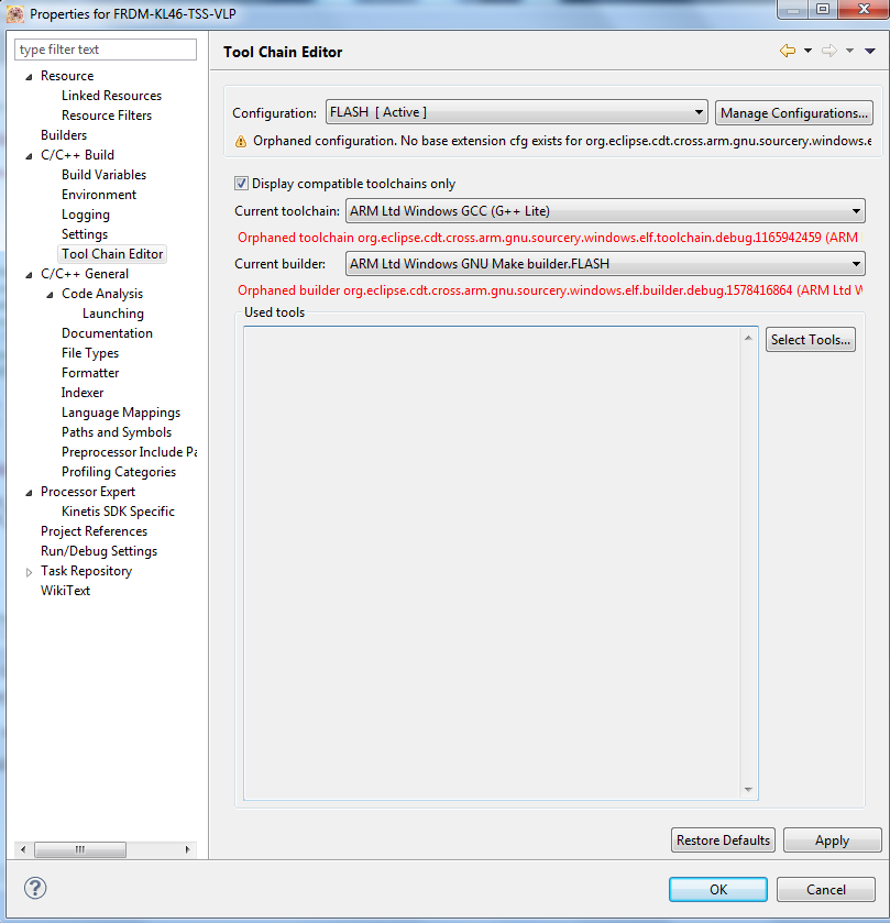

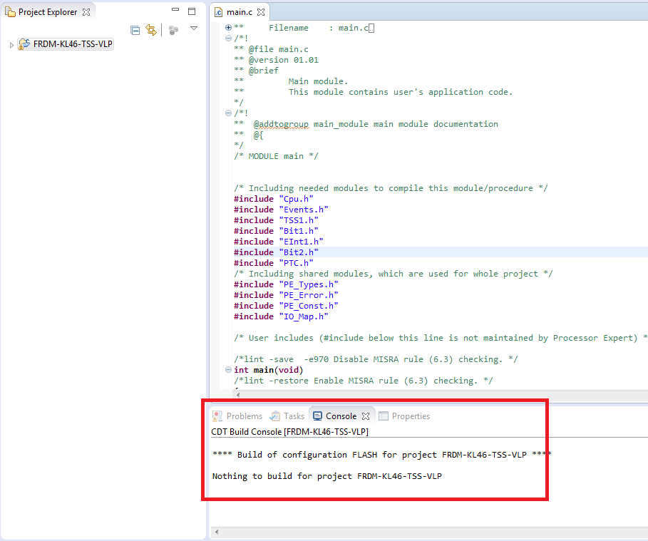

PabloBaena
Hi Adrian,
Please could you give us details on version of KDS that was used for the project, also other needed settings for building binary.  I've tried with KDS 2.0.0 and KDS 3.0.0 but is not even launching compile process. Thanks in advance,  Pablo.
5,157 Views
adriancano
Hi Pablo,
The code was developed for CW 10.6 using Processor Expert.
Hoe this helps.
Adrian Sanchez Cano
