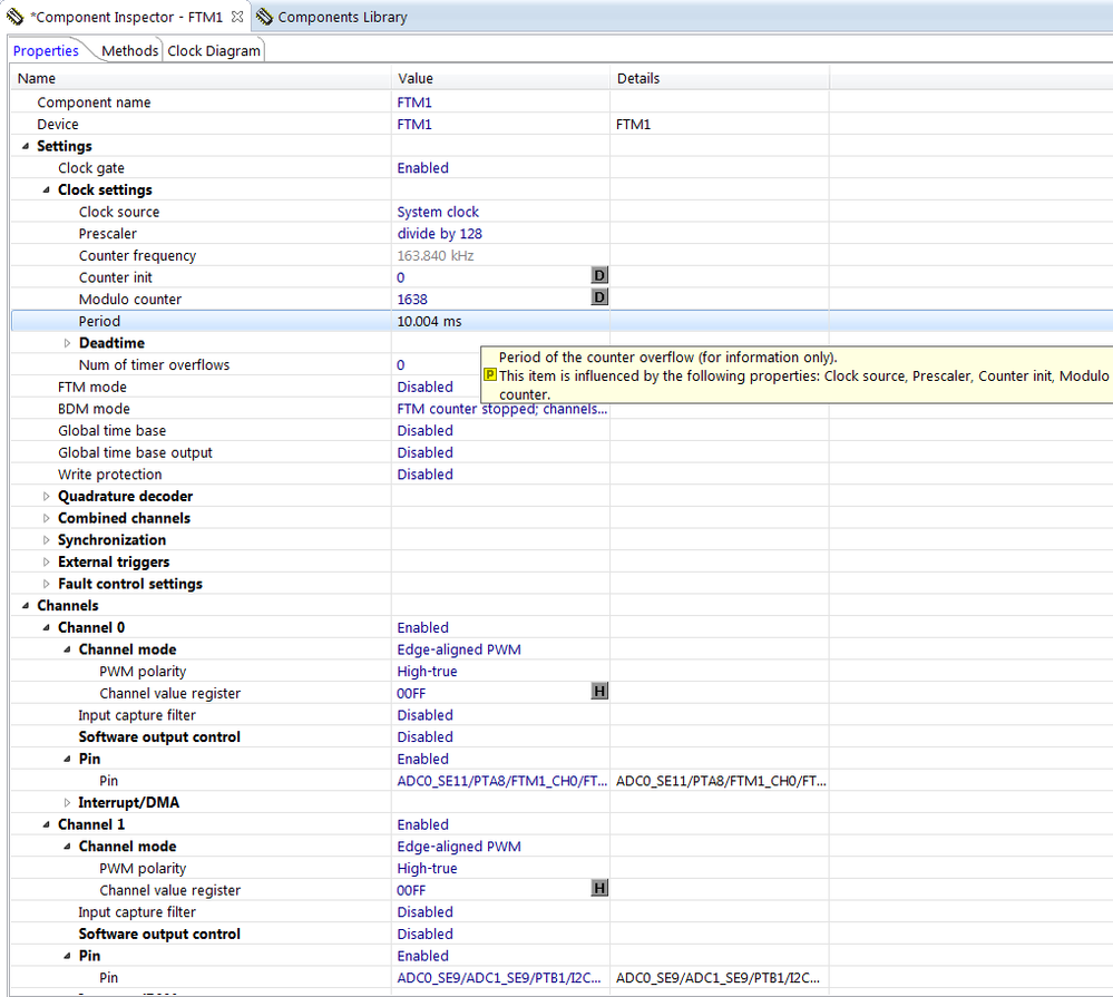

Hi to all,
I'm trying to generate PWM signal starting from fsl_ftm component.
developing with KDS 2.0.0 and KSDK 1.1.0 on K20 device (i'm using K60 for PEx because KSDK for k20 is not ready yet)
I want to generate a PWM with frequency 10 Hz and 50 duty cycle
setting of PEx flex timer are:
device FTM0
counter FTM0_CNT
basic config: overflow= 0, write protection disable, BDM = zero mode, SW trigger enabled and disabled all HW trigger
pwm chan config: Freq= 10 Duty=50,  Edge mode= high true. mode= edge alligned pwm
quadrature disabled
pin, all disabled (fault all disabled; external clock pin disabled, HW sync disabled)
init: timer overflow interrupt and fault interrupt disabled
PWM channel: #2 ---> Pin PTA5
If I use Freq > 400 Hz all work right... but if I set 100 Hz (more then my 10Hz wanted) i see a PWM of  about 550 Hz....
Why this problem occours?
thanks,
Massimiliano

Hello Massimiliano,
The fsl_ftm SDK peripheral driver (version 1.1.0) contains limitations that blocks usage of this SDK driver as you have described (one PWM channel can be initialized only; the counter prescaler cannot be selected/updated according to required PWM frequency). Your issue is caused by overflow, i.e. if you select high bus clock and low FTM counter prescaler, the modulo register cannot be set to the requested frequency of the PWM signal (the computed value is higher than 0xFFFF).
You can use Init_FTM component for initialization of the FTM device and fsl_sdk_hal component (runtime functions), e.g. you can use FTM_HAL_SetChnCountVal for PWM runtime duty settings (the duty can be computed as the ratio: Channel Counter Value Register / Modulo Counter Register. The FTM_HAL_SetMod function, that set the FTM counter modulo register,  can be used for period settings (Note: when you set the module register the duty of all PWM channels is also changed and these values must be updated to set the original duty).
The PWM period is defined by selection of the clock source, prescaler selection and Modulo Counter Register value, see the Period property of the Init_FTM component.
See example of Init_FTM configuration below. You can see that when you select Clock source and Prescaler value the counter frequency is computed (see the Counter frequency property). When you set the Modulo counter value the period is computed and displayed in the Period property. You should select the maximal value of the Prescaler to allow maximal value of the modulo register and the maximal precision of the duty selection.

marek_neuzil
Hi Dave,
It is the problem of fsl_ftm SDK peripheral driver. The FTM_DRV_PwmStart function of this component reinitialized always the whole FTM counter a the counter channel (and there is also problem of modulo register settings and prescaler). We know about this issue and the development team working on the resolution. The new version of the fsl_ftm component will be provided in Kinetis SDK 1.2.0 release.
