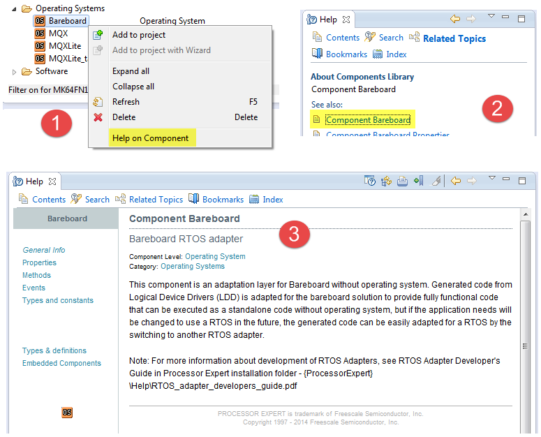

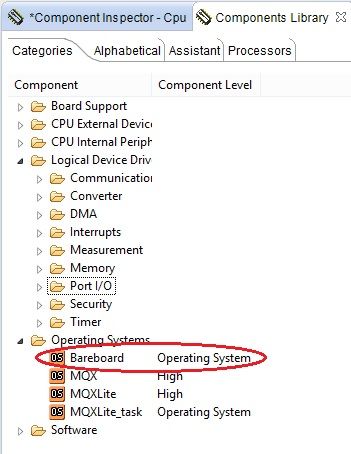

pratiekbhadrana
Thanks Jorge. I searched for logical device driver before asking, but these options didn't show up. Regarding bareboard OS component, I've attached a snapshot. I am running KDS 2.0.0

Jorge_Gonzalez
Hello Pratiek:
Sorry, I did not recall that component exists. According to the description (right click on the component -> Help on component -> Component Bareboard) this is to ease migration from Bareboard to RTOS in the future:
Personally I have never used that component and if you do not plan to add an RTOS then you don't have to use it either, just use the LDD beans alone.
Regards!,
Jorge Gonzalez
