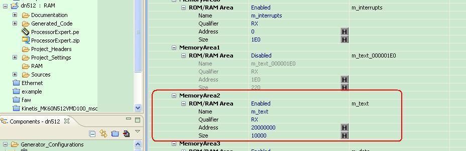

in RAM mode, you need set m_text section in RAM address. for example,
thus the generated memory section in lcf file is as:
MEMORY {
  m_interrupts (RX) : ORIGIN = 0x00000000, LENGTH = 0x000001E0
  m_text      (RX) : ORIGIN = 0x20000000, LENGTH = 0x00010000
  m_data      (RW) : ORIGIN = 0x1FFF0000, LENGTH = 0x00010000
  m_cfmprotrom  (RX) : ORIGIN = 0x00000400, LENGTH = 0x00000010
I will also attach the pe file that i modifed as i am talking above.

1) Please enable the 'Generate linker file' under 'Build Options' in CPU Componnet Inspector.
2) Click on 'Generate Processor Expert code' button to re-generate code
The generated link file will be placed under <\Project_Settings\Linker_Files\> subfolder with the name *.lcf, or *.ld, or *.cmd.
If this does not help, would you please attach the project? Thanks!
