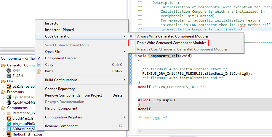

Hello Peter,
(1) You use which version of KDS ? And  you use the PE or SDK_PE ? please screenshot  your component of project .I will configure it on my side.
(2) And you can do as this, after your change the code  manually, then select "Don't Write Generated Component Modules",
the code will be you want .
Hope it helps
Alice
