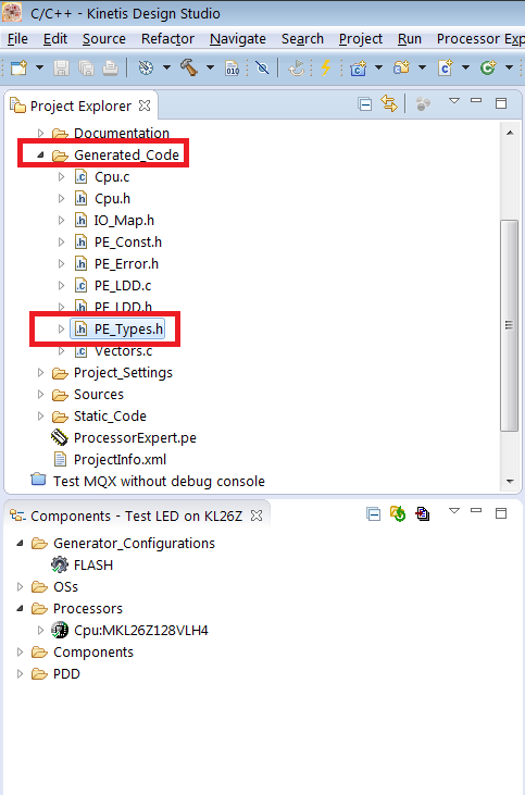

I cannot create static module using Processor expert. Any advise ? I want type define files , because i have dependancy with other module. If any detail user manual for "processor Expert", please recommend.

Nothing special project. I just to create LED blink program on KL26z board. This is first time using KDS and freescale   and I just follow the user manual. At the beginning it is OK, if I use fsl_gpio component, but if i use "LED" driver from "mcuoneclipes" component, it have some variable type "word". But this is not defined type in my project, afterthat i checked on internet, all talking about this macro define files and PE manual also have info on this. But this static modules are missing inside my  "Generatoed_code" folder. May be i doing something wrong / missing.... but this manual not have info about , how to enable/ disable this macro define file generation.
So my proplem here is , my project don't have this "PE_Types.h" file.

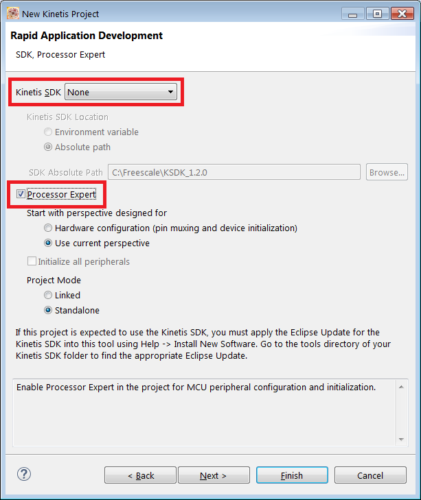

If you want to use components from the "mcuoneclipse" site you cannot use Kinetis SDK. When you create a new Kinetis Project with Kinetis SDK and Processor Expert the Kinetis SDK header files (definitions) are used instead.

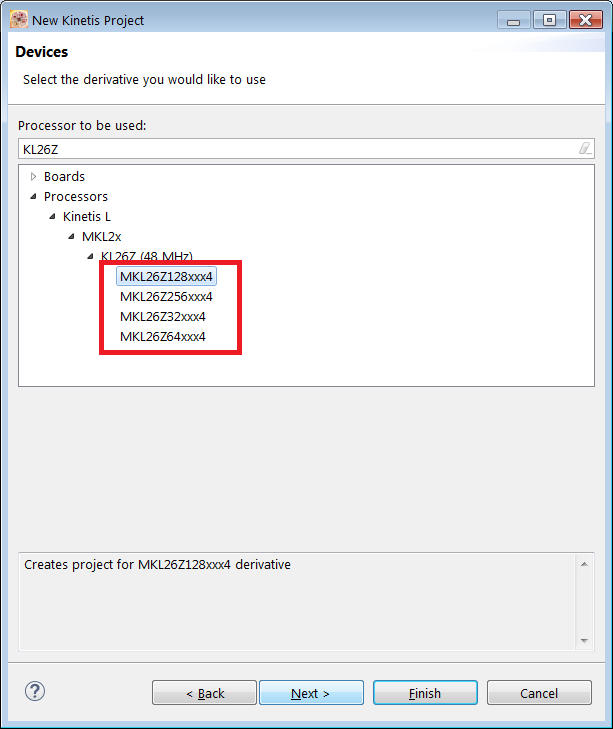

- Select the KL26Z derivative and click on the Next button:
- Select Kinetis SDK: None and check Processor Expert, click on the Next button:

A new Processor Expert project is created (without Kinetis SDK) that contain the required definition of the PE_Types.h, see below:
