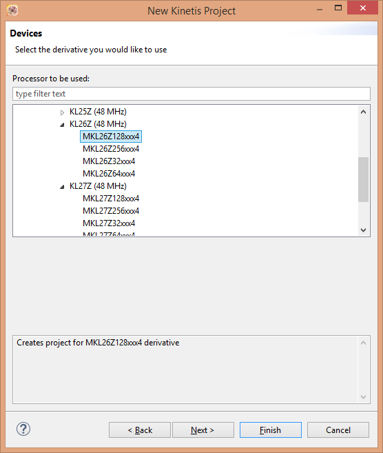

If I choose a  processor - Kinetis L -MKL2x-KL26Z - MKL26Z128xxx4 - (press next)

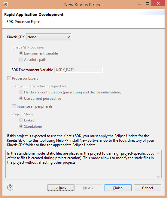

and the next window I set "Kinetis SDK  to none - it allows Processor Expert to be selected
If I choose a newer processor MKL2x-KL27Z-MKL27Z128xxx4 (press next)
and the next window I set "Kinetis SDK  to none - it DIS-ables Processor Expert.
This is same if I select another new processor Kinetis K- MK20 - MK26 -MK26FN2M0xxx18.

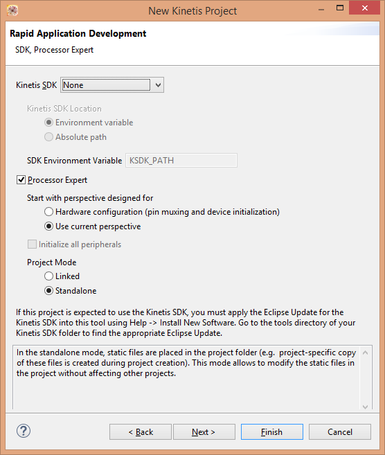

With MKL26Z128xxx4 selected
PE is enabled

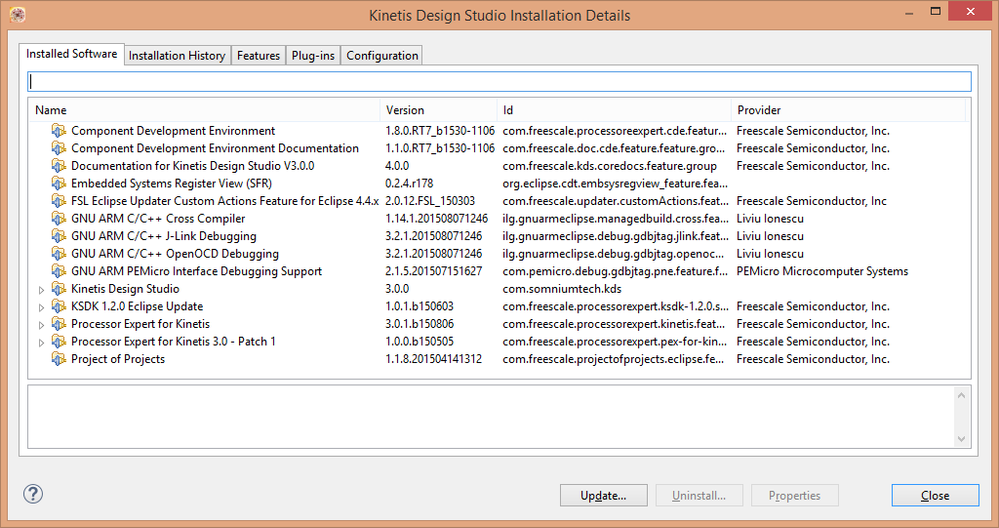

My KDS300 State is

Hello Neil:
That is expected, latest Kinetis devices have Processor Expert support only with KSDK enabled. See the same question and the links posted in the next threads:
