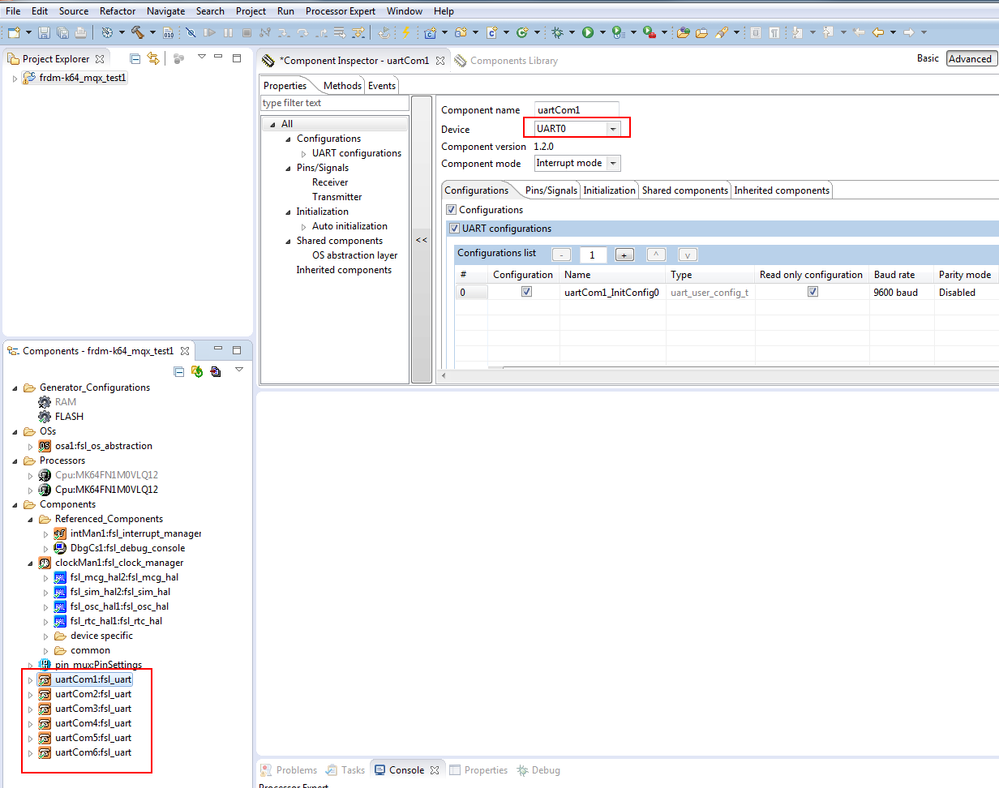

I am using KDS 2.0.0 and KSDK_1.2.0 for a project using a custom board which has a MK64FN1M processor connected to 6 RS485 ports via UARTS 0-5.
I am using Processor expert and MQX because I need RTCS and MFS.
I am struggling to see how to use all 6 ports because MQX seems to require one to be defined for the debug console. I see it is possible to use semi-hosting for debugging to the KDS console but I still can't see how to prevent MQX requiring the UART.
Any advice would be very welcome!

Hello John,
Please try disable the UART pin of fsl_debug_console, and also disable the "Aout initialization" :
while here need select one UART ,and also configuration the Baud rate .
Then add the six UART.
Hope it helps
Alice

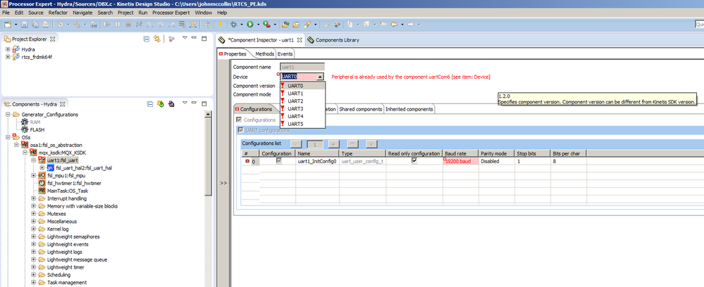

Hi Alice
Thanks very much for your reply.
I have tried your suggestion but I probably didn't explain the problem very well. I am still struggling because MQX has a UART associated with it which currently is set to use UART0. This is preventing me from adding the 6th UART to the project.
I wondered if I could use the uart1 component as it stands but I want to have control over the callback and interrupt settings. Unfortunately all of these settings are disabled, presumably because they have to be set in a certain way for MQX.
Any further thoughts?

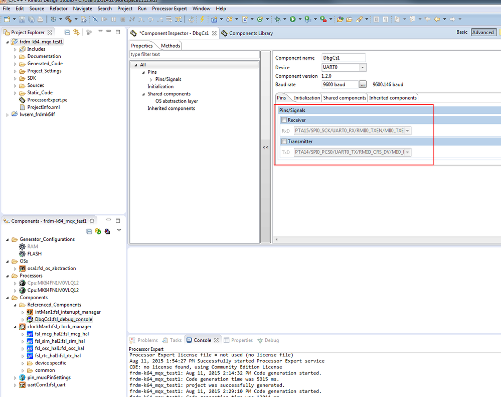

Hello John.
On my side , it can select the 6 UART with no error , please see :
And I also use KSDK 1.2, while use KDS 3.0 , i recommend you use the latest version KDS 3.0 .
While i think in you KDS 2.0 , it also can work , have you do refer to i said before :
"Please try disable the UART pin of fsl_debug_console, and also disable the "Aout initialization" :" , maybe in KDS 2.0 , it is different from KDS 3.0 ,
please fund carefully.
Hope it helps
Alice

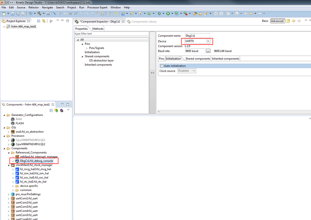

johnmccollin
Hi Alice,
Sorry, I am using KDS 3.0 and I have disabled both the UART pins of "fsl_debug_console" and disabled "Auto initialization".
Could you show me how you have set up the OS? I used the guide "How to add RTCS to a Processor Expert Project Using KDS and KSDK" to set up the project initially. It tells you to disable DbgCs1 and configure the "inherited component" debug console.
Thanks again
John

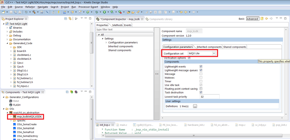

marek_neuzil
Hello John,
I see that you are using "MQX standard" version of the MQX (Alice use the MQX Lite version).
If you needn't the "MQX standard" version of the MQX you can switch to MQX Lite and you can use the 6th UART for your application according to Alice's instructions.
To switch the MQX version, use the Configuration set property in the mqx_ksdk component, see below:
Note: When you disable fsl_debug_console you cannot use the PRINTF() function.
Marek Neuzil
