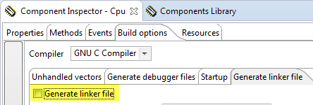

1- Disable linker file generation from CPU component -> Build options -> Generate linker file:
2- Open the linker file (ProcessorExpert.ld) and reserve space in RAM by creating a new segment (e.g. "m_interrupts_ram").

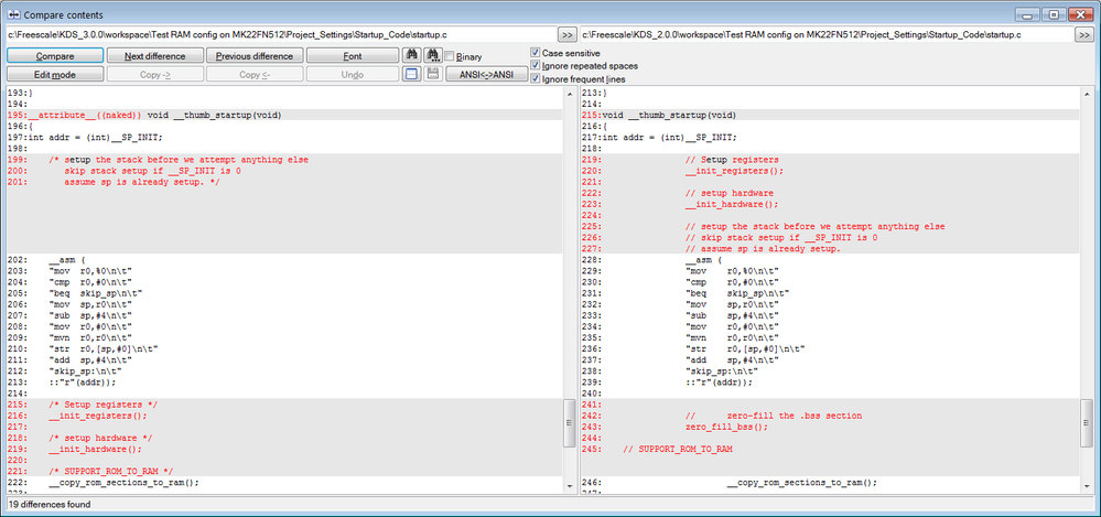

The problem has been fixed in the upcoming release of KDS 3.0.0 (it will be published in a few days). There were a bug in the startup file of the application, see the change of stack pointer initialization.
