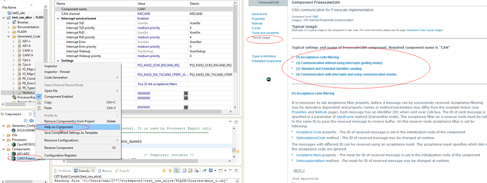

I am using S12ZVCA & Processor Exprt. I have configured the CANPHY0:Init_CANPHY & CAN1:FreescaleCAN. But I don't know how to configure a function by interrupt to read a CAN message.
I was configure as following, but got some error at build.
The PE project as attachment.
Do you have any example code or any recommend?

Hello Aaron Lee,
If you want to configure a function by interrupt to read a CAN message,  only just need the component of "FreescaleCAN", also there is example code under Typical Usage , there is how to configure component and
the demo code:

Hi Alice,
"Help on component" very useful. Thank you very much.
