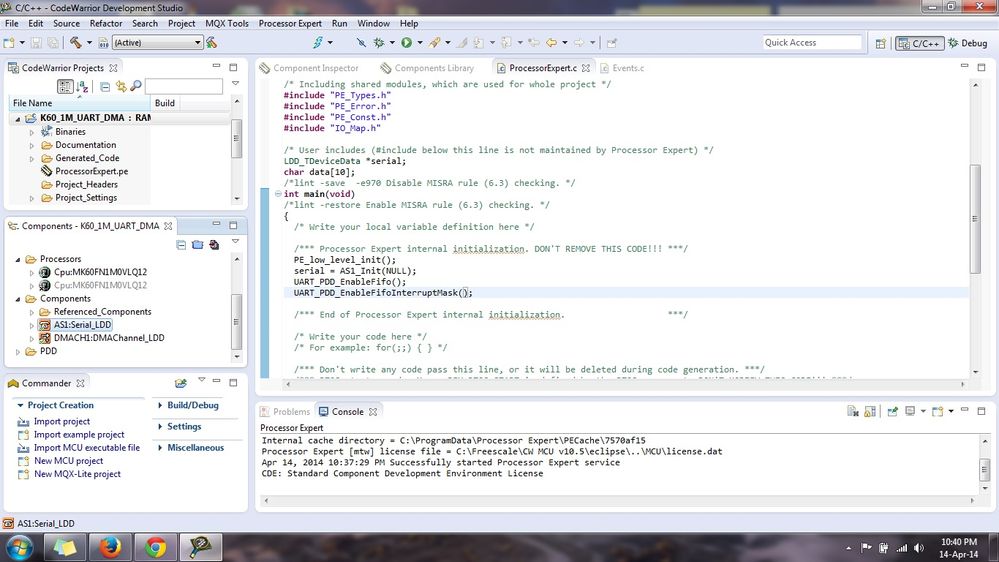

I am using K60 uc and receiving data over UART in continuous form, beside the data I am doing other processing but due to UART my program is getting delayed so I wanted to use DMA so that both the process works simultaneously. Do we have any document regarding this to make it work?

I am using Serial_LDD only the one which is present in your sample code. It automatically Assigns the name I think . See in the image also in your program , it is named as such.
So My issue was if we define the size of the buffer as 100 and only 4 char is received and we want to print that char. I am not able to do so... It Gets printed once all the 100 values are filled by the upcoming data. Is there any way to get access over any incoming data if the buffer is not filled ?

Regarding the printing of the buffer content, you can enable the method GetTransferredDataSize (switch to 'Advanced' view mode in the inspector) and use it for getting the already received number of characters.

I Due to some technical fault in my K60 board I was not able to test your code instead I Copied the settings to a K20D50M- FRDM board but it didn't work Can you please check out what I am doing wrong ? I am getting nothing in the terminal windows even after typing. I have checked the baud rate. I am attaching my K20 board's DMA code which I copied from the one which u send.

The K20DMA project is OK but the DMA_LDD component (DMAInit function) contain an error in CW MCU 10.5 (the project works in CW MCU 10.6.1 when it is imported, re-generated and builded).
There is an workaround for this issue. Open the file MCU\ProcessorExpert\lib\Kinetis\pdd\inc\SIM_PDD.h in your CW MCU 10.5 installation and do the following modification:
Rename the symbol SIM_PDD_CLOCK_GATE_DMA_MULTIPLEXOR to SIM_PDD_CLOCK_GATE_DMA_MULTIPLEXOR0 for the MCU_MK20D5.
