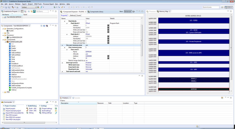

Hi all,
i´m using CW 10.6 with PE Core 1.4.1.
The core selected is a KE02Z16 with 256 bytes internal EEPROM.
When i try to use the component MEMORY -> On-chip EEPROM, i can´t do it.
Why? Is this a bug, o simply the component for the KE family has not yet  been released? By when?
How could i "workarround" this?

Hello Raul,
The EEPROM of MKE02Z16 is supported by  the FLASH_LDD component. You can see an example of settings on the screenshot below. For more details see the help of FLASH_LDD component.
Marek Neuzil

santiago_gonzal
Hello Raúl,
Apparently the IntEEPROM component is not supporting Kinetis E yet.
A possible workaround for you is to create the project for a S08P MCU, add the IntEEPROM component and generate the code. Then you can port the generated code to your Kinetis E project.
