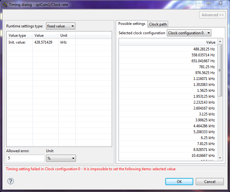

I am trying to add an SPI component using processor expert.
I can't do it because it reports an error when I try to generate the code.
Using the Component Inspector I see where the error is
Logically I try to correct it using the Timing dialog box:
By selecting a clock configuration I get a list of possible settings but whichever I choose it keeps saying there is an error.
Obviously I am doing something wrong or I am missing something.
Can anyone tell me what that might be ?
No joy yet, I have been at this all morning and I Have noticed the following extra things:
- The timing dialog box does not show any possible values when the selected clock configuration is "ALL".
- If I select a value in any one of the single Clock configurations I always get a "Timing setting failed in Clock configuration x" message for another clock configuration.
- If there are no applicable common values that would be logical but how do you set it up so there are
- I can click on "clock path" and it shows the path for "Clock configuration 0". I can't select another one or make changes to it.
- Advanced stays greyed out.
- I have messed around with activating clock configurations 0...3 in the CPU but no difference whatsoever.
- How do you specify to use a particular clock configuration ?

Well, I finally worked it out. For some reason I do not know I had multiple clock configurations (4 of them) and it turns out the "Timing dialog window" can't deal with that.
Reducing the clock configurations to 1 cures it completely.
In the mean time I have included the fsl_cmp, fsl_i2c, fsl_spi and fsl_lpuart components.
The last three all showed the same problem until the number of clock configurations was reduced to 1.
I can now generate the processor expert code, build the application etc....
Problem solved but it took the best part of today and a fair dose of irritation and headache.
