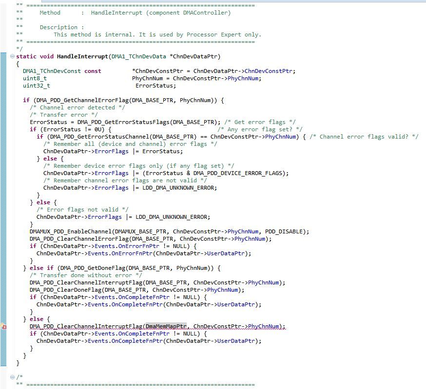

I am trying to use the DMA_Channel_LDD module of Processor Expert on the MK22FN512xxx12 processor.
It seems like there is an (obvious) error in the code generated in file DMA1.c
I am attaching the following clip from the HandleInterrupt() function.
Almost at the end (see error mark), the DMA_PDD_ClearChannelInterruptFlag() macro uses the symbol DmaMemMapPtr, instead of DMA_BASE_PTR!
This causes the code to fail to compile!
4,721 Views
marek_neuzil
The defect has been fixed and we have prepared the hot fix package for KDS 2.0.0. See the attached hot fix package.

Hello Bruno,
I have tried to reproduce the error but I can build the application without any error. The DmaMemMapPtr is defined as a local variable in the HandleInterrupt function, see below. Could you send me the project to reproduce the error, please?

brunopaillard
Hi Marek
Just to let you know: In the project that I sent just now the code will compile because I have manually changed the offending symbol to DMA_BASE_PTR.
But I have not disabled Processor Expert's code generation, so you will just have to regenerate that code in order to see the error again!

marek_neuzil
Hello Bruno,
Thank you for the project. I have reproduced the error and I have reported the issue to Processor Expert development team (PEXMCU-2134).
Marek Neuzil

marek_neuzil
Marek Neuzil
4,721 Views
brunopaillard
Thanks Marek, that works!
