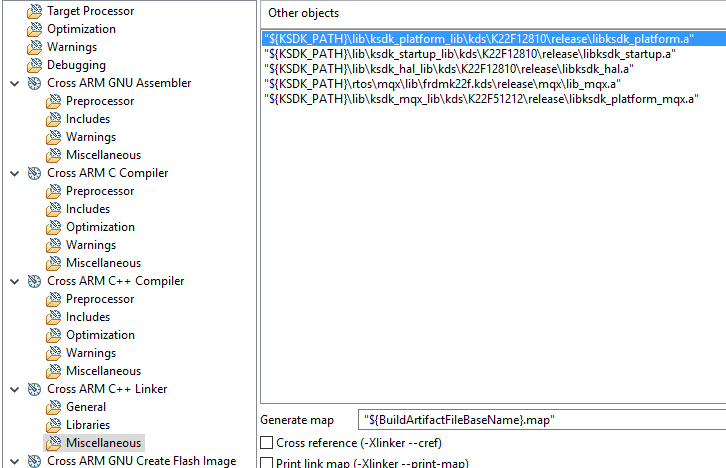

I'd like to get away from having the KSDK source files linked to my project.  Ideally, I would precompile all of the KSDK libraries and then just add them to my project's linker's miscellaneous files.
So far, I believe I need, and therefore have precompiled the following:
  • ksdk_platform_lib
  • ksdk_startup_lib
  • ksdk_hal_lib
  • lib_mqx
  • ksdk_mqx_lib
I then added references to the files in my linker settings like so:
I think I'm really close.  Unfortunately, at the moment I get one undefined reference to DbgConsole_Init().  I am unable to delete or disable this component without PEx getting really upset with me.  I have been unable to find the location of DbgConsole_Init in any of the libraries.  All I can think of at the moment is that I need to add a link to  /platform/utilities to pull in fsl_debug_console, but wanted to see if anyone here had the same question and conclusion as me.

If I import the /platform/utilities folder to my project as a virtual folder, then I can make the DgbConsole_Init() undefined reference go away and the project builds.  However, at the moment it doesn't run properly, which is another topic for discussion at a later time.
