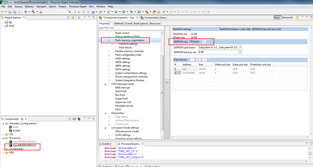

Hi Arturo,
You needn't add other components , only double click the Processor ,
choose " Flash memory organization " , then you  can configure EEPROM refer to your requirement :
Hope it helps

I see how I should configure EEPROM from CPU, but which methods I should use in order to save date in EEPROM and capture from it. I don’t see these methods in CPU component to save and capture dates in the EEPROM, Don’t you use any component to save and capture dates? Maybe saving and capturing in the flash you could manage to do the same, couldn’t you?

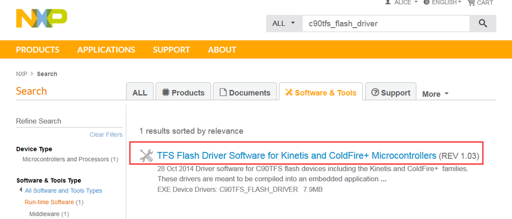

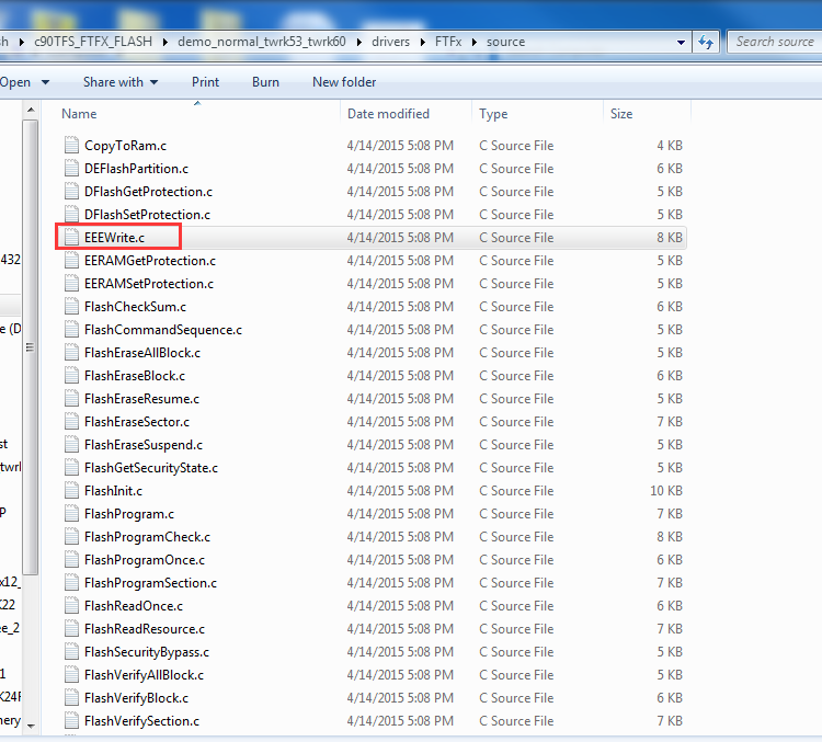

There isn't the Write function for EEPROM in PE code,  you can  use or refer to the "Flash driver" on
NXP site :
Search Results: c90tfs_flash_driver
It includes the EEEWrite.c file, you can use it on KDS.

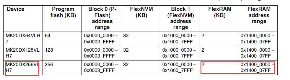

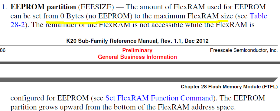

3.  About the maximum size of EEProm  , please check your chip's Reference manual :
So for your chip, the maximum size of EEPROM is 2K .
