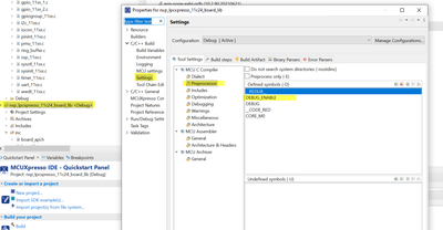

I found a similar post from 2018 but the question was not answered directly - how to setup OM13093 eval board hardware, LPC11C24 MCU, sample LPCopen project like /..._ccan_rom or /_uart projects to send debug printf messages out to the PC console terminal (not on MCUXpresso IDE console tab).
I'm asking for direct clear answers because I don't understand the links from help/manual sections of MCUXpresso, etc. and they are not specific to LPC11C24 and OM13093 eval board which does not have any R29 / R30 UART_TX/RX connections to USB right now.   E.g printf(), semihosting, VCOM, etc.  Clueless.
So please provide clear instruction on what to do in both HW and SW aspects of the matter.
* What to do on OM13093 eval board for connection?  Tiny silkscreen - I can't find where R29 and R30 are for shorting.  Please point it out on PCB.
* what header / library files to use for the 11C24_* project to make UART->VCOM->USB -> Terraterm console to work?  (Is that series of interface correct or not?)
* what library header functions to include in the project to use printf() or putc() or whatever else to do in the software project
*... and all other else are needed which I missed on the above list.

Hi Alice,
I got your full answers on the Tech Support ticket I opened.  It worked.  Thank you.
I'm able to use DEBUGSTR(str) macro (non-printf) as enabled by the "DEBUG_ENABLE" define in properties and do the other steps summarized below.
The only extra effort I had to do outside of this matter is to implement an "itoa()" integer to ASCII function because DEBUGSTR cannot use formatting of integers/numbers ala-printf() style.  It only accepts ASCII strings.
So to summarize and for completeness with the hope of helping others who may ask about this matter, these are the 3 things that need to be done on the LPC11C24 eval board, OM13093UL:
1) Set/add DEBUG_ENABLE definition on the MCUX project's properties under Properties -> C/C++ Builds -> Settings -> Preprocessor (as shown on screenshot given before.
2) To use the USB J4 port to interface with a PC serial comm port terminal (e.g. Terraterm), put jumper/resister (0 ohm) on R29 and R30 on the eval board.
3) No work needed to connect RXD and TXD to PIO1_6 and PIO1_7 because they are already connected to the expansion JP2_9 & _20
Hope that helps.

Hello @mi7engr
Have replied you in your private case.
Alice
6,095 Views
Hello @mi7engr ,
1) Enable DEBUG_ENABLE of board_lib project as below:
2) Connect PIO1_6 (RXD) and PIO1_7(TXD) to PC using a UART to USB.
Then you can see the characters printf() to terminal .
Alice
