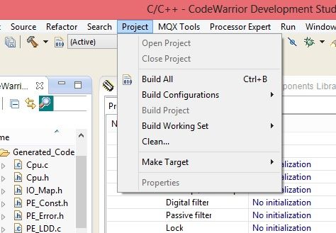

I am currently trying to generate the code (on page 19 in the document), but I do not see the "Generate Processor Expert Code" option under the drop-down menu, in fact this is what I see:
I have installed the latest version of codewarrior, "CW_MCU_v10.5_SE". How should I proceed with the turorial? Did I need to install or download additional stuff?? Anybody's help would be very much appreciated.

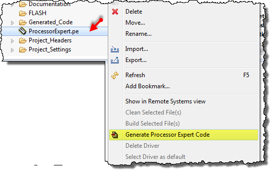

The tutorial was for CW v10.1, and things are a little different in CW v10.5. But do not worry, you can generate code with next options
A- Right click on ProcessorExpert.pe and click on "Generate Processor Expert Code"
B- Or simply click on the little icon from the Components View.
Hope this solves your doubt
Regards!

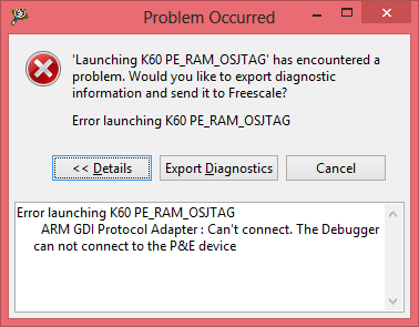

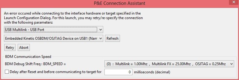

I have one last problem, which is establishing connection with the board... I get the following errors when debugging:
I am not sure how to troubleshoot this, I had previously downloaded and installed the necessary driver from PEmicro (I think...) . I downloaded the two setup applications: "pemicro_osbdm_osjtag_tower_toolkit" & "PEDrivers_install". Am I doing something wrong or missing something? I am using the OSJTAG Mini-B USB connector, and I had removed all the jumpers. Any help would be appreciated, thanks for all of your time!

There are several possibilities for CodeWarrior not communicating properly with your programming tool, e.g. incorrect or corrupted USB drivers, long or loose cable connections. Please run a search here in the community and you will find a bunch of information about this problem.
Regards!

I found this blog Virtual COM/USB CDC for OSBDM/OSJTAG | MCU on Eclipse and updated the board's firmware and reconfigured the jumpers (not sure if it matters), and voila, it worked!

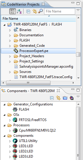

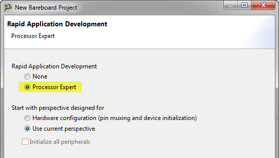

The dialogs in the new project wizard have been slightly changed. Select MK60DN512 as device (Kinetis K Series, K6x Family, K60D (100 MHz Family):
Then go through the dialogs, and at the end there is the option to select Processor Expert:
The biggest change is that instead of a 'Project Panel' view, the components are in its own 'Component' view:
I hope this helps,
