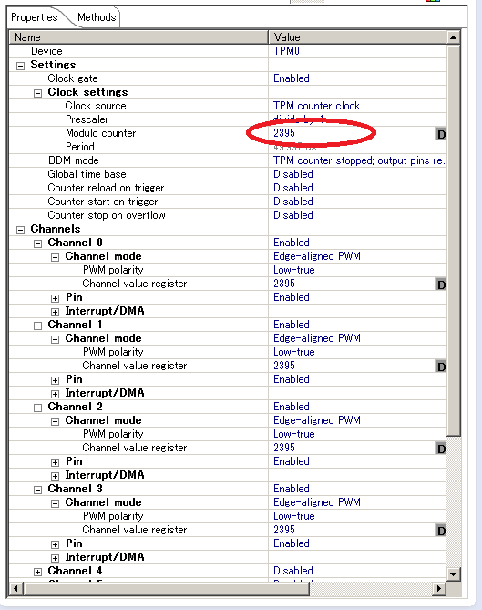

I found two problem on Processor Expert.  Are these reported ?
CW10.5, CPU KL16
1: TPM0
  Default value of Modulo counter is 0.  I think this should be 0xFFFF.
2: UART1
  Clock setting has a bug.  The baud rate that is shown "Baud rate" is missing.  It looks like the baud rate  is calculated with ++divisor.
  For example, Baud rate divisor 6 should be Baud rate 249600 baud but 213942.857 baud under bus clock is 23.9616MHz.
Zak

zaksawa
Happy New Year :-)
Thank you for your responce.
Both problems are on Init_xxx.  Please check attatched PICT.

Petr_H
You are correct, we have reproduced both issues and confirm that they are defects.
We are sorry for the inconvenience, both problems will be fixed for the next release of Processor Expert.
Both issues can be easily workarounded:
- In Init_TPM, it's just the after reset value is not set properly. Any user-set value should work as expected.
- In Init_UART in case UART1 is set, the user has to expect that the shown baudrate is not correct as it's calculated using divider+1 value
