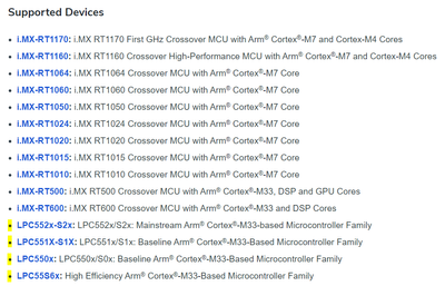

Yes, MCU SPT work on ISP for the LPC55xx. The compatible devices list is at the following link: MCUXpresso Secure Provisioning Tool | NXP Semiconductors.
[MCUXpresso Security Provisioning Tool List of Supported Devices]

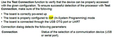

Also, there you may find the MCUXpresso Security Provisioning Tool User Manual, which might come in handy if you decide to use the tool: MCUXpresso Secure Provisioning Tool User Guide v.5. In here it mentions the possibility and use of ISP in the supported devices.
[MCUXpresso Security Provisioning Tool User Manual. Section 6.1.5. Connection]
